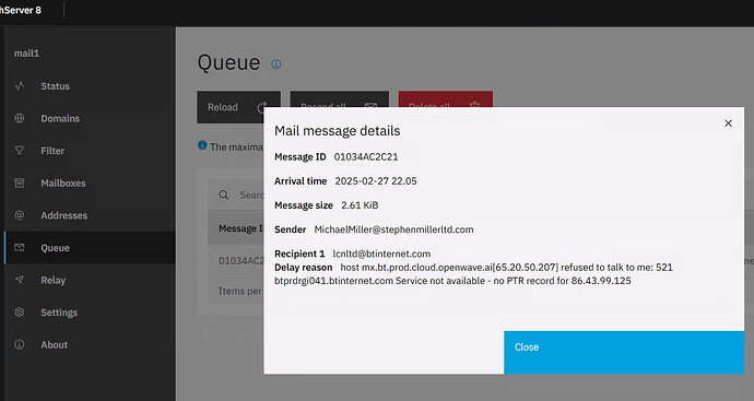

All email is working now both direction, was stuck in outbound queue but hae it freed now by disabling a relay. No just to get rid of the michael michael@ns8.test no option to delete?

Yes that worked and I only see the correct email now. But this time it’s getting stuck in the queue. Am guessing that there is no SPF domain txt/mx records, I have just added one. Will take while to take an effect.
