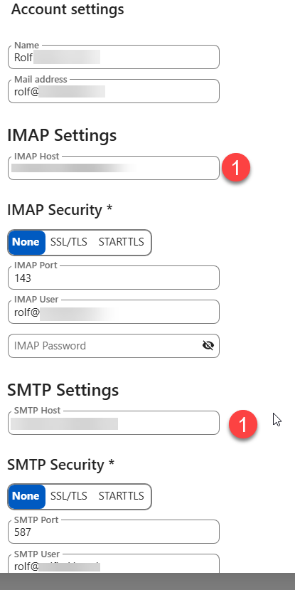

Did you set IMAP and SMTP security to “None”?
I guess if the mail server is on another node than the Nextcloud app in your cluster, then you need to enable “SSL” or “STARTTLS”

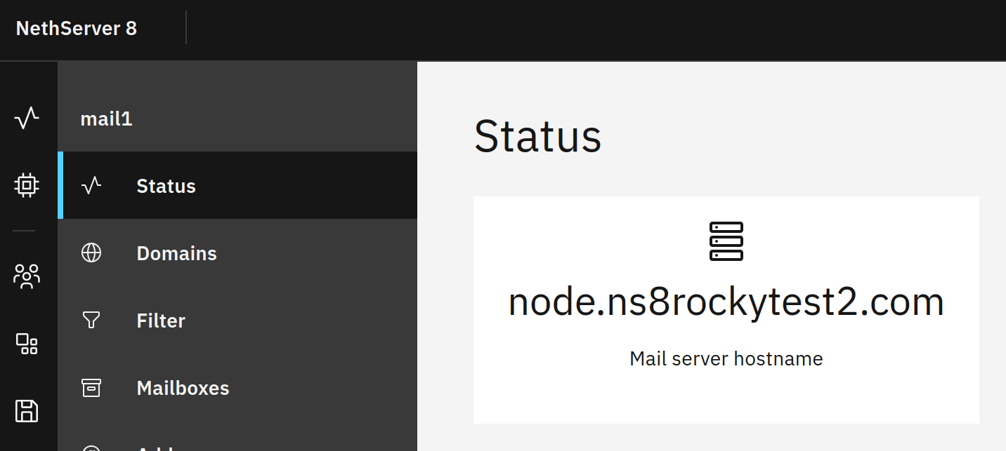

Did you enter the correct mail server hostname, you can find it at the mail server app status page:

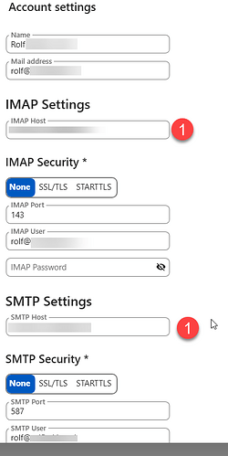

thanks, now it works.
My settings:
  • disabled shared mailboxes in NS8 settings
  • Nextcloud mail settings:
(Host at (1) is the FQDN for mail as is shown in NS8 config tile.)
