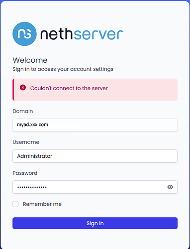

I’ve now reinstalled NS 8 on the same VM. After that, the initial setup went smoothly. First, I installed and configured Samba AD. That worked fine so far. However, just like on another NS 8 instance, I’m having trouble logging in to the User Portal. Even though this is a brand-new installation.
What’s going wrong here?

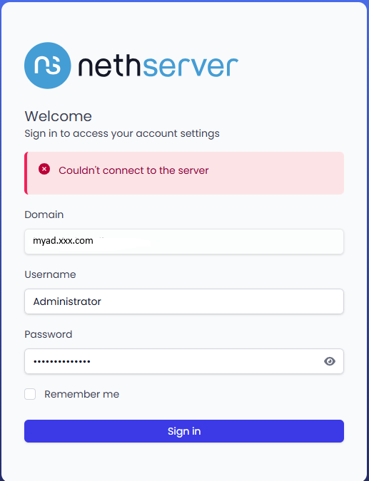

I tried to reproduce the issue without success, installation and user portal are working here.
My user portal is reachable at https://node.ns8.test/users-admin/ad.ns8.test and I’m able to login as Administrator.
Are there errors in the logs when you try to login?
Is the samba domain reachable from the NS8?
ping myad.xxx.com
The samba domain is reachable from NS 8.
That is all what i can find in the logs.
2026-08-04T13:30:32+02:00 [1:samba1:samba-dc] Auth: [Kerberos KDC,ENC-TS Pre-authentication] user [(null)][Administrator@XXXXX.XXXXX-ONLINE.COM] at [Tue, 04 Aug 2026 11:30:32.850676 UTC] with [aes256-cts-hmac-sha1-96] status [NT_STATUS_PROTOCOL_UNREACHABLE] workstation [(null)] remote host [ipv4:192.168.154.1:48201] mapped to [XXX-ONLINE][Administrator]. local host [NULL] 2026-08-04T13:30:33+02:00 [1:traefik1:traefik] 192.168.154.122 - - [04/Aug/2026:11:30:28 +0000] “POST /users-admin/xxxxx.xxxxx-online.com/api/login HTTP/2.0” 499 21 “-” “-” 110 “samba1-amld-https@file” “http://127.0.0.1:20000 ” 5007ms 2026-08-04T13:30:33+02:00 [1:samba1:samba-dc] Auth: [Kerberos KDC,ENC-TS Pre-authentication] user [(null)][Administrator@XXXXX.XXXXX-ONLINE.COM] at [Tue, 04 Aug 2026 11:30:33.884264 UTC] with [aes256-cts-hmac-sha1-96] status [NT_STATUS_OK] workstation [(null)] remote host [ipv4:192.168.154.1:41698] became [XXXXX-ONLINE[Administrator] [S-1-5-21-4040196191-2615639880-851222450-500]. local host [NULL] 2026-08-04T13:30:37+02:00 [1::qemu-ga] info: guest-ping called 2026-08-04T13:30:41+02:00 [1:ldapproxy1:ldapproxy] 2026/08/04 11:30:41 [info] 25#25: *9 client disconnected, bytes from/to client:1343/228090, bytes from/to upstream:228090/1343 2026-08-04T13:30:41+02:00 [1:samba1:api-moduled] [GIN] 2026/08/04 - 13:30:41 | 200 | 12.7s | 192.168.154.122 | POST “/api/login” 2026-08-04T13:30:42+02:00 [1::qemu-ga] info: guest-ping called
mrmarkuz
(Markus Neuberger)
August 4, 2026, 1:08pm
8
I guess it’s the same error as in the other thread . Is there also the LAM error again?

Let’s check the network…
ip a
…and the Samba config:
api-cli run module/samba1/get-configuration | jq
It’s a fresh installation without any app. Only samba is installed.
Output of ip a:
1: lo: <LOOPBACK,UP,LOWER_UP> mtu 65536 qdisc noqueue state UNKNOWN group default qlen 1000
link/loopback 00:00:00:00:00:00 brd 00:00:00:00:00:00
inet 127.0.0.1/8 scope host lo
valid_lft forever preferred_lft forever
inet6 ::1/128 scope host
2: enp6s18: <BROADCAST,MULTICAST,UP,LOWER_UP> mtu 1500 qdisc fq_codel state UP group default qlen 1000
link/ether bc:24:11:a8:4f:32 brd ff:ff:ff:ff:ff:ff
inet 192.168.154.1/24 brd 192.168.154.255 scope global noprefixroute enp6s18
inet6 fe80::be24:11ff:fea8:4f32/64 scope link noprefixroute
3: wg0: <POINTOPOINT,NOARP,UP,LOWER_UP> mtu 1420 qdisc noqueue state UNKNOWN group default qlen 1000
link/none
inet 10.5.4.1/32 scope global wg0
Output of Samba config:
“configuration_required”: false,
“credentials_required”: false,
“realm”: “xxxxx.-online.com”,
“domain”: “ixxxxx.xxxxx-online.com ”,
“nbalias”: “”,
“nbdomain”: “XXXXX-ONLINE”,
“ipaddress”: “192.168.154.1”,
“ipaddress_list”: [
“label”: “enp6s18”
“ipaddress_alterable”: true,
“hostname”: “dc1”
mrmarkuz
(Markus Neuberger)
August 4, 2026, 2:42pm
10
Network and samba config looks good. I tested a similar setup and it worked.
Maybe try the curl command from the other thread to check the latency, adapt NS8FQDN,ad.xxx.com and PASSWORD to your setup.
curl -k -s -o /dev/null -w '%{http_code} %{time_total}\n' \
-X POST https://NS8FQDN/users-admin/ad.xxx.com/api/login \
-H 'Content-Type: application/json' \
-d '{"username":"Administrator","password":"PASSWORD"}'
It should return something like
200 0.714507
mrmarkuz
(Markus Neuberger)
August 4, 2026, 3:02pm
12
Status 000 means a timeout after about 5 seconds.
If you try the command again, Is there always a timeout?
Do the hostnames resolve to the NS8 LAN IP address? If they resolve to public IPs, the firewall may block the request…
nslookup NS8FQDN
nslookup ad.xxx.com

Does it work when you use the IP instead of the NS8FQDN or does it time out too?
-X POST https://192.168.154.20/users-admin/ad.xxx.com/api/login \
