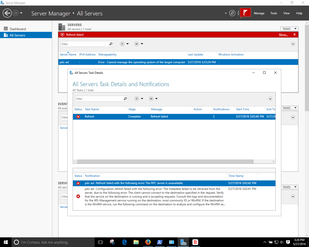

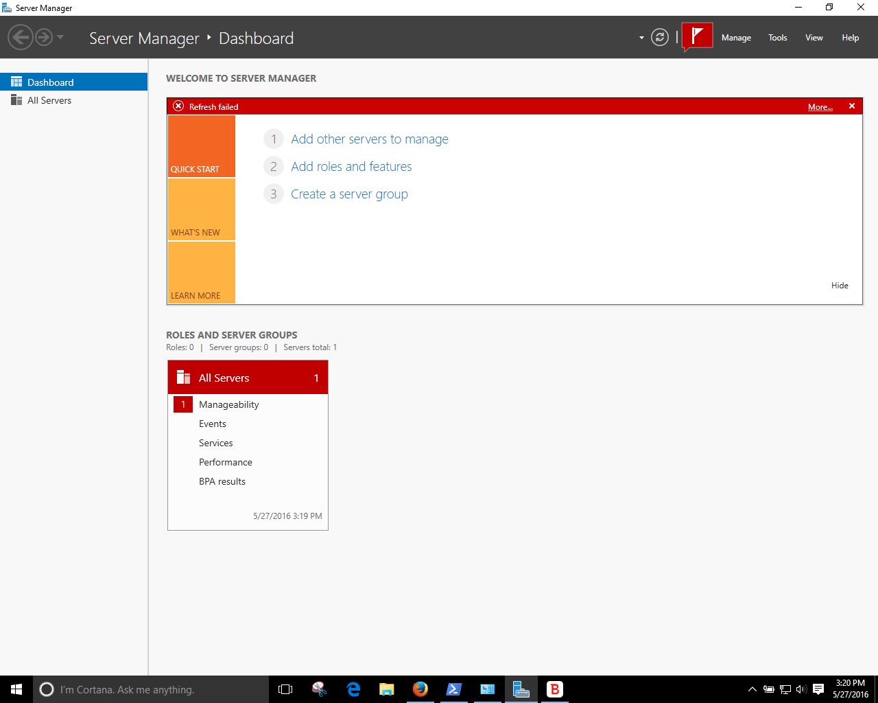

Hi Davide,
Can you help me with “How to manage NS 7a3 - Samba4 AD with RSAT installed on Windows 10”?
I think is the final test for Samba 4 AD on NS7a3 regarding Windows in this moment.
I will also try to add an Ubuntu computer in Samba 4 AD (I don’t know how but I will learn, also with the NS Community support).
After that, Sharing files and folders, when will be available.
So, I’m stuck here: please see the attached pictures

These ports must be opened?
In this case I must to add “Basic firewall” module from “Software center” to configure the rules/services/ports?
Is there other approach or isn’t necessary to open those ports?
If those ports must be opened, can be opened by default when you add/configure “Account provider: Samba Active Directory” module?
Or, more simple question: where and what did I wrong?
TIA,
Gabriel
The linux container running samba DC has an open firewall setup: no need to change port settings!
Remember the IP address you entered before pressing “Start DC”: that is the AD IP (and not the NS one)!
RIGHT!
