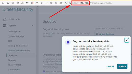

The first check I did was the update. Everything went well although the last time I tested the update of the first “stable” version of NethSecurity, at the end of the update, a note displayed that “xxx packages have been updated”. This note does not appear anymore. I thought: “It’s not a big deal”.
I then checked again if there were still updates. “4 ddns packages, 1 luci-app and 1 git” were still available. I update, still no note of the updated packages. I check a second time and again the same packages are still available. I try again and again the same packages are still available.
I reboot and again the same: “4 ddns packages, 1 luci-app and 1 git” were still available.
I do a “Factory reset”, I try an update and this time, NethSecurity displays that everything is up to date…

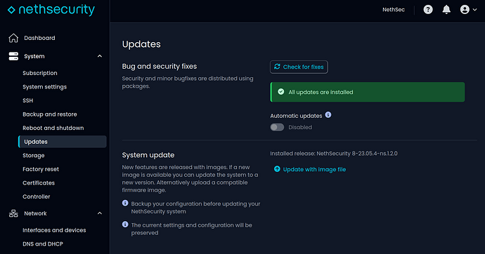

I’m sorry, I can’t reproduce on Proxmox, after install and check for fixes it looks like this:

As written above, this was not there:

Update: After deleting the virtual hard disk in proxmox and reimporting the image the “wrong” updates didn’t appear anymore.
