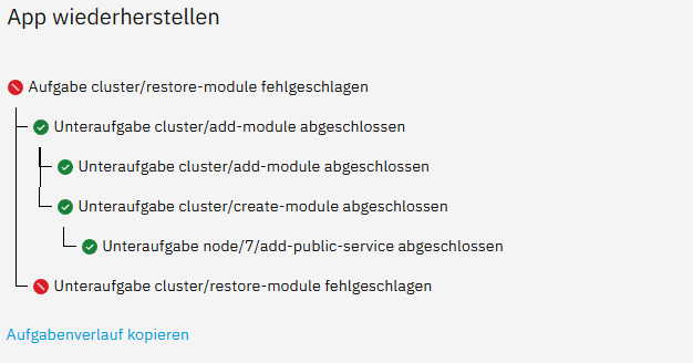

restoring sambe to the 2nd node gives:
grafik
<5>IP address 192.168.178.13 not found. Falling back to VPN IP address

  File "/home/samba2/.config/actions/restore-module/80start_amld", line 36, in <module>
    response = agent.tasks.run(
  File "/usr/local/agent/pypkg/agent/tasks/run.py", line 39, in run
    results = runp([taskrq], **kwargs)
  File "/usr/local/agent/pypkg/agent/tasks/run.py", line 50, in runp
    return asyncio.run(_runp(tasks, **kwargs))
  File "/usr/lib64/python3.11/asyncio/runners.py", line 190, in run
    return runner.run(main)
  File "/usr/lib64/python3.11/asyncio/runners.py", line 118, in run
    return self._loop.run_until_complete(task)
  File "/usr/lib64/python3.11/asyncio/base_events.py", line 654, in run_until_complete
    return future.result()
  File "/usr/local/agent/pypkg/agent/tasks/run.py", line 120, in _runp
    return await asyncio.gather(*runners, return_exceptions=(len(tasks) > 1))
  File "/usr/local/agent/pypkg/agent/tasks/run.py", line 129, in _run_with_protocol
    return await run_apiclient(taskrq, **pconn)
  File "/usr/local/agent/pypkg/agent/tasks/apiclient.py", line 47, in run_apiclient
    taskctx['status_path'] = await _retry_request(_apost_task, taskrq, client=client, theaders=theaders, **kwargs)
  File "/usr/local/agent/pypkg/agent/tasks/apiclient.py", line 191, in _retry_request
    raise exhttp
  File "/usr/local/agent/pypkg/agent/tasks/apiclient.py", line 166, in _retry_request
    retval = await request_procedure(*args, **kwargs)
  File "/usr/local/agent/pypkg/agent/tasks/apiclient.py", line 258, in _apost_task
    jresp = await resp.json()
  File "/usr/local/agent/pyenv/lib64/python3.11/site-packages/aiohttp/client_reqrep.py", line 1104, in json
    raise ContentTypeError(
aiohttp.client_exceptions.ContentTypeError: 0, message='Attempt to decode JSON with unexpected mimetype: ', url=URL('http://cluster-leader:9311/api/module/traefik3/tasks')

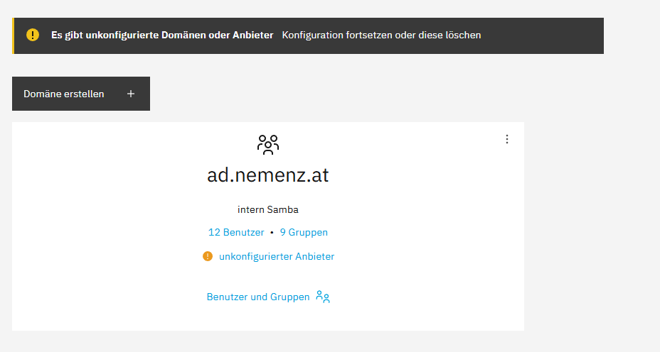

on the domains and user page

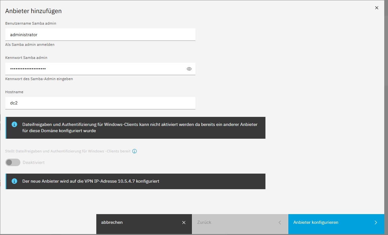

trying to configure
After promoting the new Node as leader node (becouse there would be no connection to the cluser-admin) and turning off the old node there isn’t samba workin at all. no DNS, No loginserver.

It seems both Mail and Samba restoration failed for the same reason. They receive an unexpected response from api-server.
Check the system load:
top -n 1 | head -3
Check the contents of /etc/hosts on EVERY cluster node:
cat /etc/hosts
Can you make a backup/restore test with another module (e.g. Dokuwiki)?
top during a restore process?

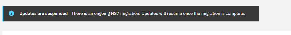

For some reason I have this msg on the softwarepage and don’t know why. The migration is over already :
but I already dis some core updates reacently. maybe not since last friday
Probably not, since it worked right now with doku wiki.
But the question is, what to do now?
Why says my Cluster a migration is ongoing?
Sorry I didn’t understand :smiley: However if you say Dokuwiki restoration works the error Attempt to decode JSON with unexpected mimetype is not permanent.
It is a safety check triggered by a NS7 node still present in both VPN (last seen < 12 hours) and Redis configuration.
If the migration has finished but you still see it blocking the updates, follow the instructions in Core 8.3 release notes: Release notes — NS8 documentation.
thank you. there where 3 bogus nodes there.

  • Tried to restore endet with this Errors:
restic --option=rclone.program=/usr/local/bin/rclone-wrapper dump b842e0c1ad8eeff0f3b430f32a609ec4e7771c9c728ed1a33ce25e82fa31d8b1 state/environment
Assertion failed
  File "/var/lib/nethserver/cluster/actions/restore-module/50restore_module", line 93, in <module>
    agent.assert_exp(restore_task_result['exit_code'] == 0)
and
restic --option=rclone.program=/usr/local/bin/rclone-wrapper restore --json b842e0c1ad8eeff0f3b430f32a609ec4e7771c9c728ed1a33ce25e82fa31d8b1 --target . --exclude state/environment
Trying to pull ghcr.io/nethserver/restic:3.4.4...
Copying blob sha256:3685f91b5ebb60fb1fba5e9bae10d7bccca10b6da3a10c938faac9ee6f27edf8
Copying blob sha256:993cf9c50bf4a10805d429d083bfb2ab1828fc59eea3a0168a7fc4919b3994f4
Copying config sha256:ac2bd7bbaf8ce17ac622369a24e65c899769f4766506f50b751995a0e867bf52
Fatal: unable to open repository at rclone::smb:backup/ns8Backup/samba/745ad09f-8089-49e5-8c41-687b1f10b4d8: error talking HTTP to rclone: Get "http://localhost/file-9883504075434524555": context deadline exceeded (Client.Timeout exceeded while awaiting headers)
<3>Restic restore failed {}

It seems Samba restoration failed while connecting to the backup destination, the ā€œbackup/ns8Backupā€ directory shared on some SMB file server.
Ithink I found the mistake:
Since the Backup is on a smb share on the nas its unaccessible during reinstall of samba :unamused:
There is no 2nd domaincontoller in my network.
How can I mount this share in nfs or something to access the backups?
