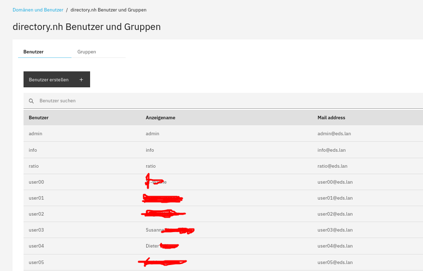

The problem is:
Since beginning of may it is not possible to share a document INSIDE the user domain, without using email. At example user01 share a document direct with user09…
There is a chaos in domain directory.nh - see what I mean:

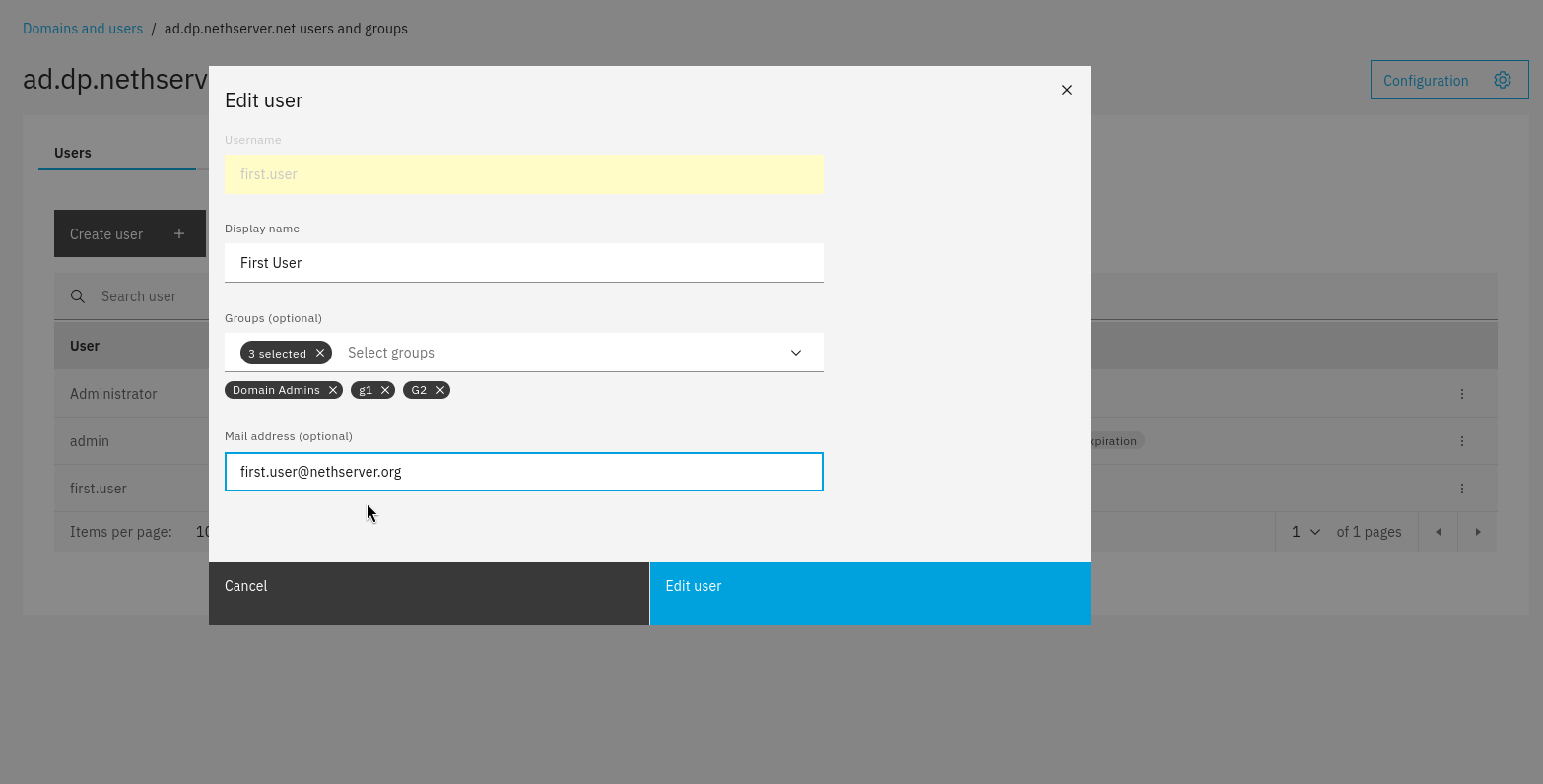

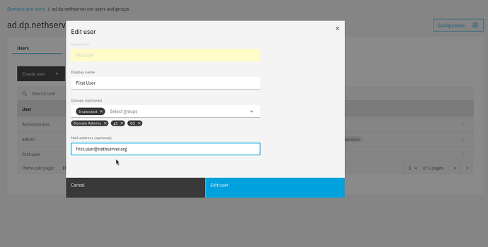

I tried to reproduce the issue but without success.
After migrating Nextcloud and OpenLDAP to NS8 using the domain “directory.nh”, I’m still able to share files among users, using the old domain name.
