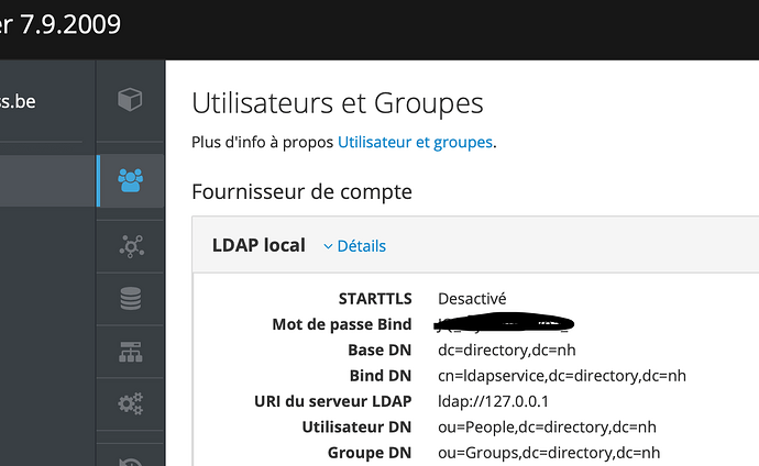

The source machine currently uses a Domain Controller for accounts, and Nextcloud is configured to synchronize its internal accounts via LDAP.
In the past, I have encountered issues when migrating accounts that were assigned different UUIDs, resulting in a failure to sync with the existing accounts in the migrated Nextcloud instance.
Has this problem been resolved? How can I mitigate it?

If I understood correctly the NS7 is connected to an external AD account provider. Is it a Windows Server?
Nope, a local NS7 DC account provider.
