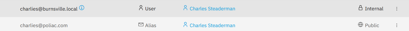

Is “charlies” defined in the Addresses page? What are its destinations?
Did you change addusers flags recently?
Since I didn’t know that there was an addusers flag, I didn’t make a change on purpose.
