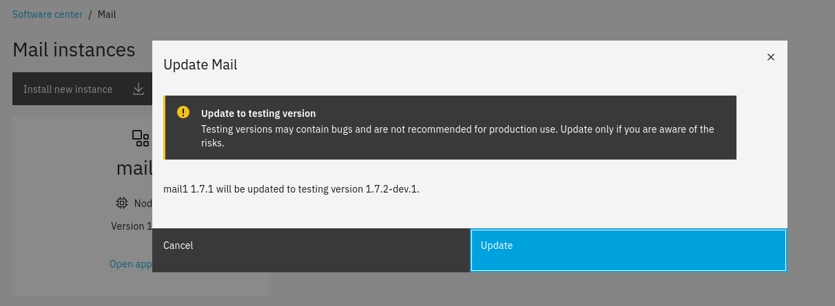

Mail version 1.7.2-dev.1 is available for testing. You can upgrade to the testing version from the Software Center page.
We tested your setup in lab and we are confident the warning message does not apply to your environment :slight_smile:
For any issue you can revert the update with the commands above

Mail version 1.7.2-dev.2 is available for testing. Fixes the access of user/group addresses in combination with a mail domain named after the LDAP user domain.
I updated to 1.7.2-dev.2 and it appears to be working.
Should I revert and wait for the formal release?
No, I think you can keep it.
If there are other issues, just revert to the latest stable.
Version 1.7.2-dev.3 is available for testing. It reduces the number of LDAP queries during Postfix address expansion. I’m already running it on my production server.
It can be installed from Software Center, with the Update to testing version action.
