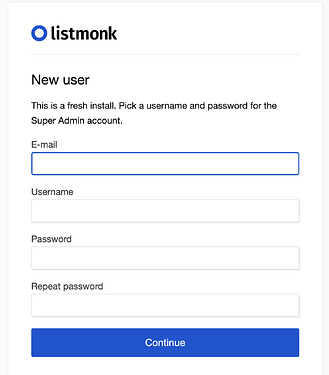

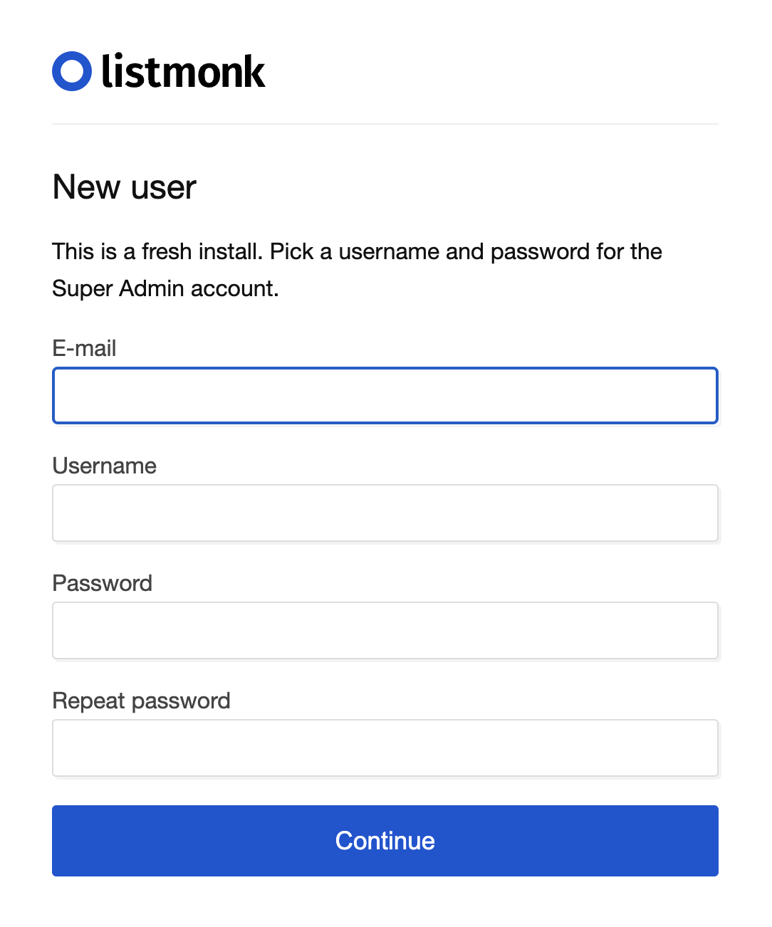

  • admin and password provided during configuarion are ignored. At first access login leads to ‘create first new user’

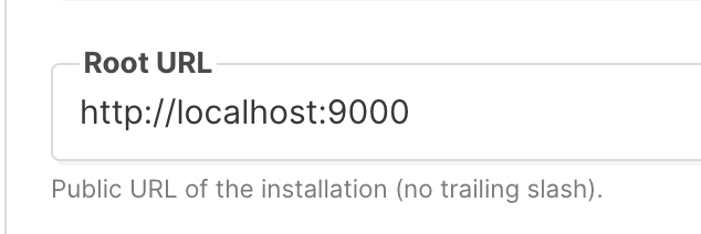

  • By default the root URL in settings is not set to FQDN, which leads to errors.

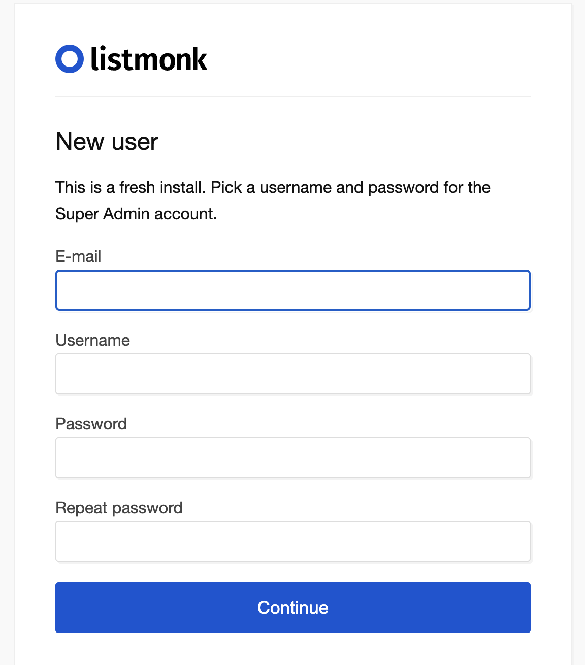

Where I already created a new first user before restart. And indeed settings are lost when accessing the FQDN:

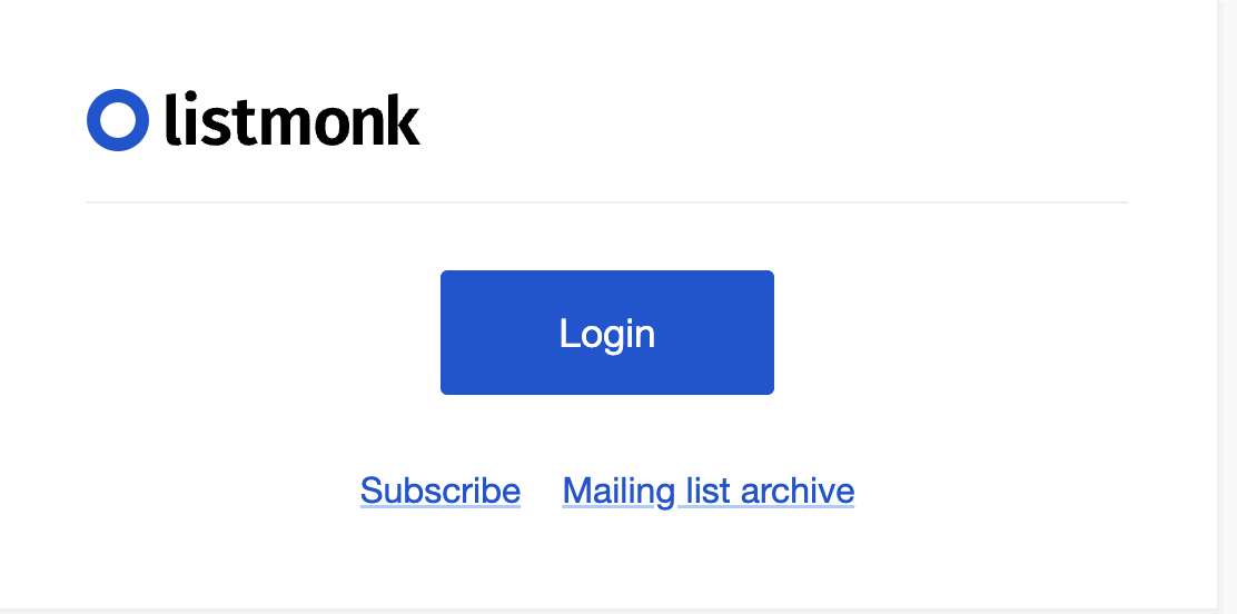

Installed and configured, provided user and pass. Going to FQDN:
Clicking login:

Both mailing archive and subscribe links at the login window:
http://localhost:9000/subscription/form
http://localhost:9000/archive
Are these ports ok?

I think this you manually have to change i tried setting the base url but the app crashes
So i had to put ip “0.0.0.0:9000” for it to work
