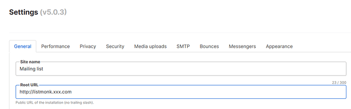

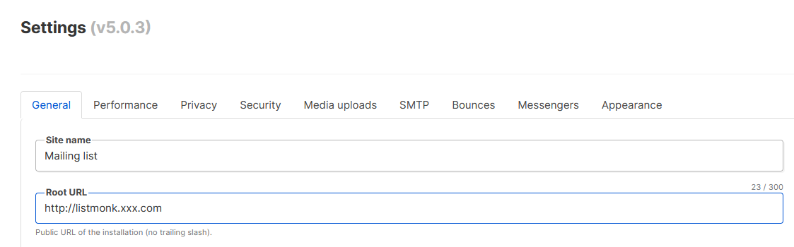

Looks good so far. Butt he question is, what i have to put into this field.
Screenshot 2025-08-15 135143
The fqdn listmonk.mydomain.com dont work. Or is it a problem with the firewall of NS 8 and i have to open port 9000?

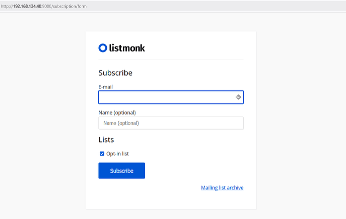

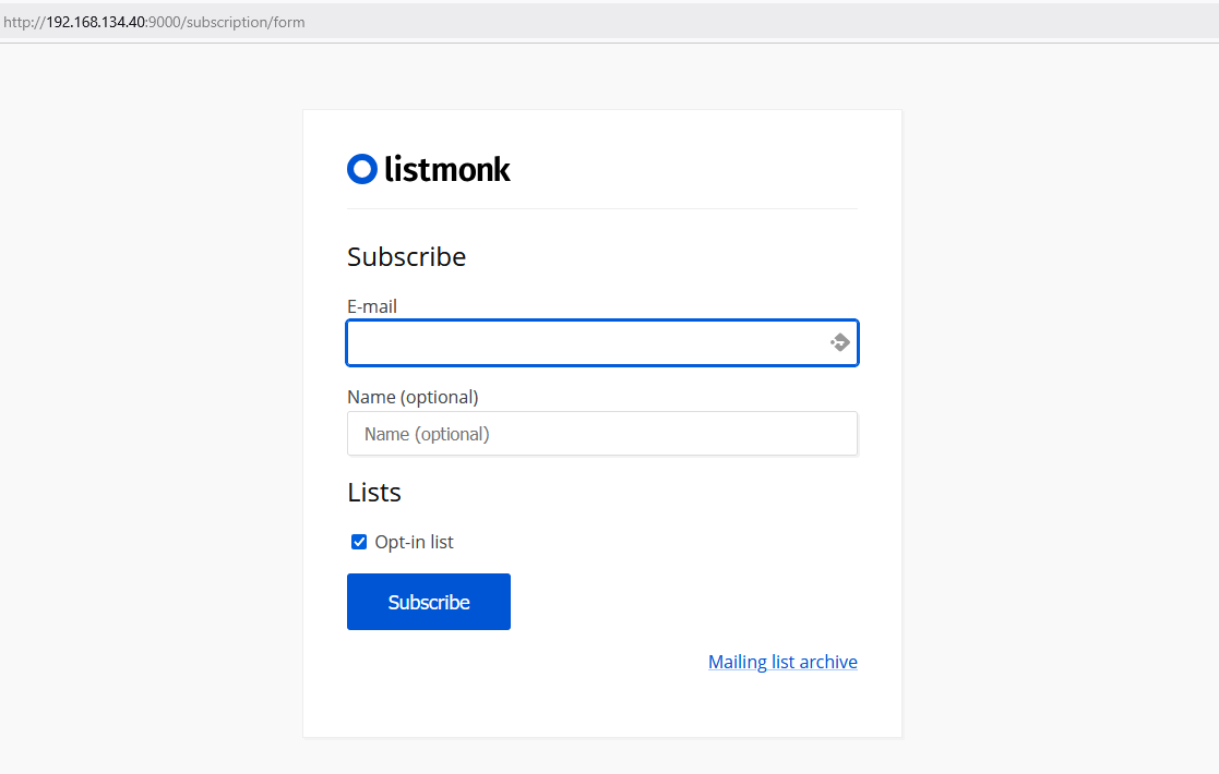

Hi @oneitonitram
When I use this docker-compose.yml and install it on my server (Ubuntu 24) via Portainer, it works with 192.168.xxx.xxx:9000.
When i use http://listmonk.mydomain.com without any portnumber, it’s usable.
You changed the fdqn in the list monk interface or in the docker compose
I changed the fdqn in the list monk interface.
Yeah in the list monk interface its possible but when you change it in the docker compose the docker container crashes
If I change that on the listmonk page and it works, then that’s fine.
