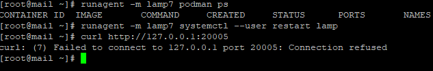

Are the webserver containers running?
runagent -m webserver1 podman ps
Does it help to restart the Webserver app in the Software Center or on CLI:
runagent -m webserver1 systemctl --user restart webserver
Does it work to browse to the webpage by it’s original FQDN that’s set in the webserver app like webhost.domain.com?
Does it work locally? (Adapt the port 20007 to the used one)
curl http://127.0.0.1:20007

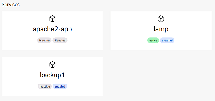

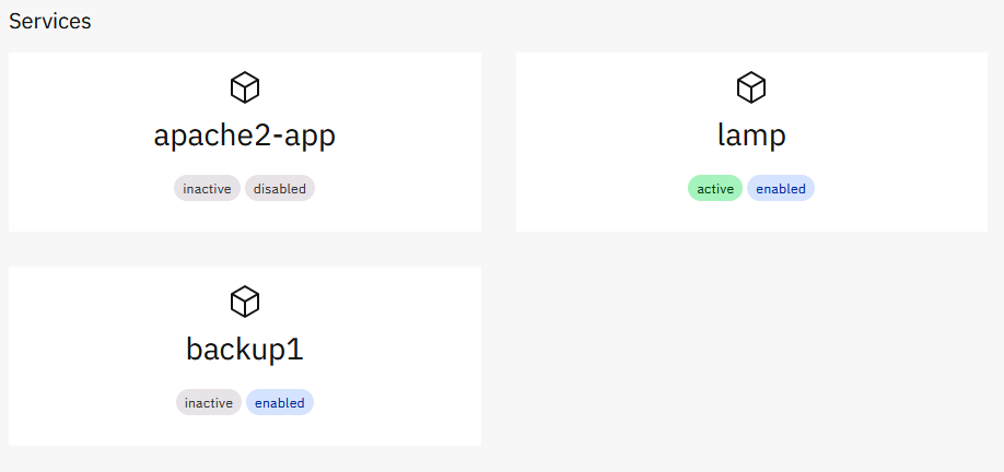

Are the lamp services active?
Hi, even if I restart the instance it doesn’t start the apache service.

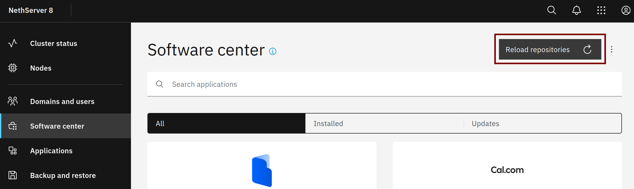

I have NethForge enabled, but there still isn’t option to update the application. I disabled and enabled it again, I also disabled stephdl repository and didn’t help.
How could I solve this?
Did you try to reload the repos?

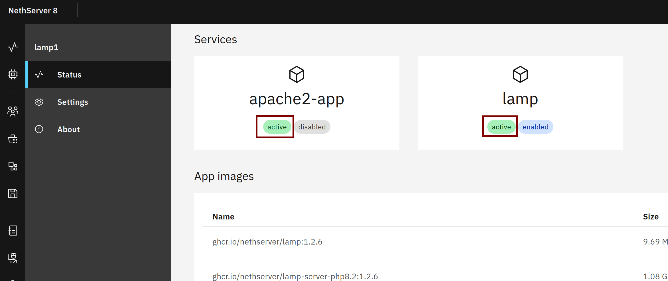

add-module ghcr.io/nethserver/lamp:1.2.6
I installed new instance now via cli. Is there a way to recover database from old instance? I haven’t deleted it yet.

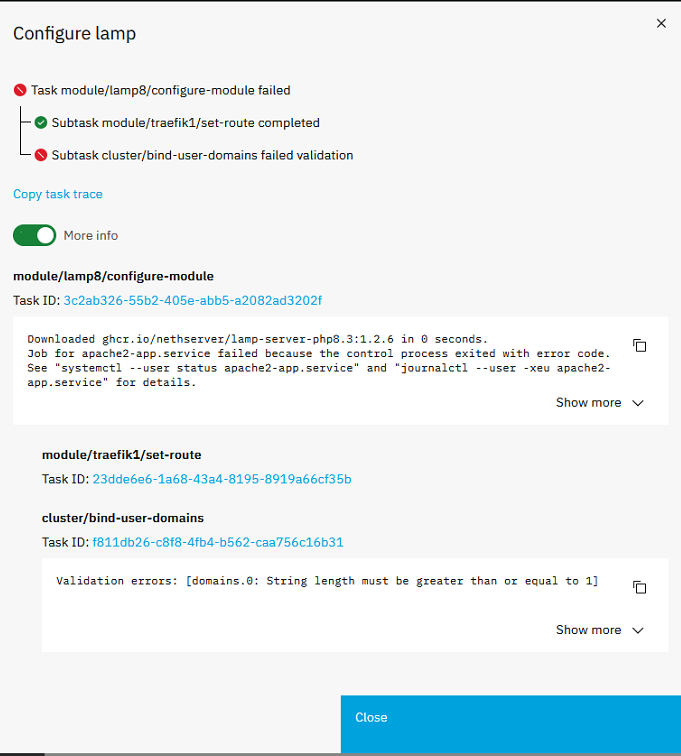

New problem :man_facepalming:
I think it’s a permission issue due to copying the database.
The copied database dir (in this example it’s named database) has the wrong owner: (root instead of the number)
# ls -l /home/lamp2/.local/share/containers/storage/volumes/mysql/_data/
total 123324
-rw-rw----. 1 1018502 1018502    417792 Mar 13 13:37 aria_log.00000001
-rw-rw----. 1 1018502 1018502        52 Mar 13 13:37 aria_log_control
-rw-rw----. 1 root    root            9 Mar 13 13:38 database
-rw-rw----. 1 1018502 1018502      1297 Mar 13 13:37 ib_buffer_pool
-rw-rw----. 1 1018502 1018502  12582912 Mar 13 13:33 ibdata1
-rw-rw----. 1 1018502 1018502 100663296 Mar 13 13:33 ib_logfile0
-rw-rw----. 1 1018502 1018502  12582912 Mar 13 13:38 ibtmp1
Please fix owner and group to the number instead of root:
chown -R 1018502:1018502 /home/lamp2/.local/share/containers/storage/volumes/mysql/_data/database
Now the configuration of the app should work again.
