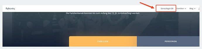

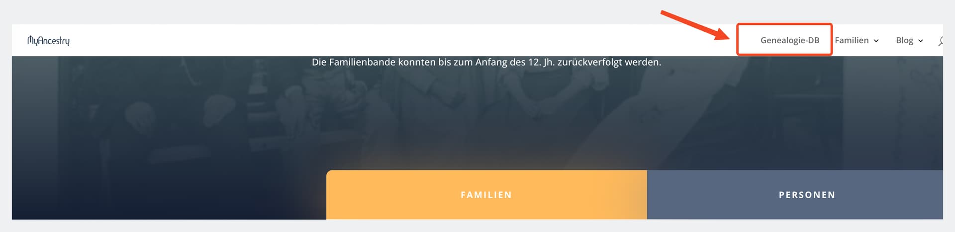

https://www.myancestry.de
embedded in WordPress
direct link: ...MyAncestry – myAncestry - Genealogie der Familien Bernd, Dargel, Prescher, Klepp, Wendenburg u.a.
