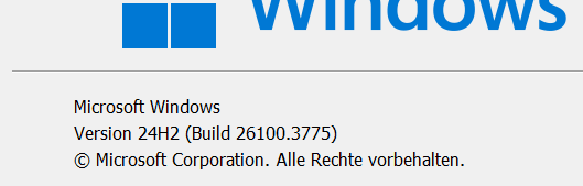

Which Windows version is used on the client?

I’m going to test it using Win 24H2 and report…

Suggestion from me. If you are using a Proxmox server, then install a virgin WIN11 24H2 on it and try to join the domain.
