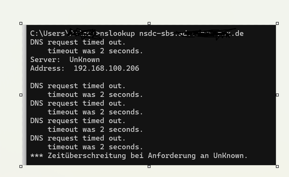

dont have another client here, sorry. puh… ns8 is… challanging in so many ways. for example the dhcp and dns was easy from the configuration, now i have an dhcp on a pihole, dns also, the ns8 works now, after really a lot of probs and now, where i thought okay, should be fine, the next thing. from the beginning i remember that i have to pick the ns8 as first dns server, after that the join to the domain was okay. i have the ns8 as first dns and now it did not work. its often frustrating… espiacaly for me as a non pro. i ping the nsdc-sbs.ad.domain.de and this worked perfectly, if i do the nslookup from the dns name resulution samba it show me an error.

I think you need fix the DNS (nslookup) issue.
