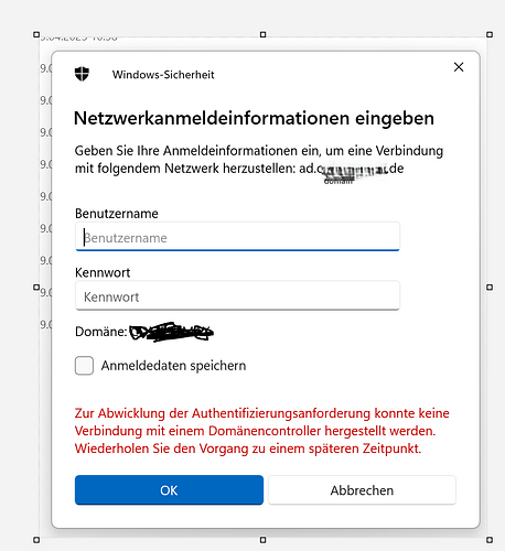

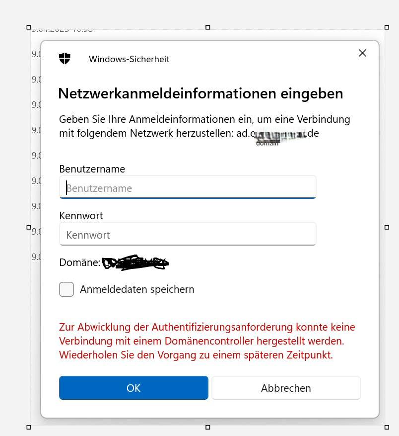

After i do the whole client new i dont have access to the domain controller, i am member of the domain, as an administrator but i i try to change the owner of a few files or folder i am not able to connect to the domain controller… its insane.

if i try to reach by \dc1.ad.domain.de this happen
Sorry, what do you mean by reaching the AD? Using the RSAT tools?
This error can be ignored.
no, but if i try to give someone else access to a folder i must reach the active directory to choose him.

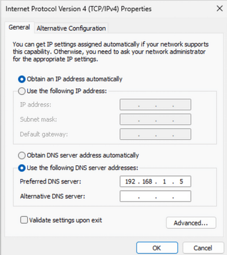

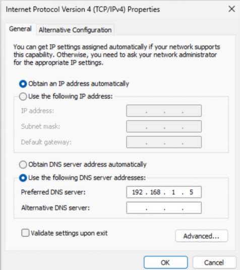

What happens, if you set on the client the dns server to the NS8, where samba is installed, and then try to join to the domain?
Like so, but replace ti with the NS8.Smaba ip:
i was able to join the domain already but i think it is not working well with samba and dns. if i go with rsat tools on domain controller i see everything and also that i am a joined maschine/user.

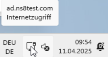

in windows the Network shows to which Network u r connected, finally i make it here…
It should also work with NS8:

The client that should be rejoined needs to use a DNS server that knows about the samba domain and ideally forwards to it.
So either the client uses the samba DNS directly or some other DNS server (pihole?) that conditional forwards to the samba DNS.

As a workaround you could set the DNS server that the client uses to the samba domain controller IP. Then the join should work.
