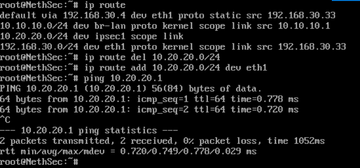

when I try to connect to the remote network it does not find it, when I use ping it returns “Destination Host Unreachable”. I’ve checked the route table and found the route.
One thing that stands out for me is the fact that it uses a (I believe) virtual interface, as far as I know ipsec does not create an interface for the vpn (unlike openvpn), but on Nethsecurity it does (maybe it is a implementation difference).
I made a test, removing the route using the virtual interface and added the WAN interface instead:

Before I make any adjusts in the routing table:
- Nethserver → Nethsecurity (ok, I can connect fine)
- Nethsecurity → Nethserver (does not work)
After I fix the routing table (only in the Nethsecurity, since Nethserver does not create a virtual interface:
- Nethserver → Nethsecurity (stopped working)
- Nethsecurity → Nethserver (works fine)
Well, that is it. My lab is on proxmox. I don’t believe I made any mistake on the setup, and the Ipsec connection is established, the one thing that bugs me is the virtual interface and the routing table using it. If someone had this issue or can add up to this I would appreciate, if any more information is needed, just ask me and thanks in advance for your help.
