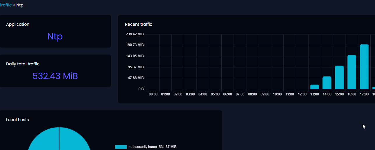

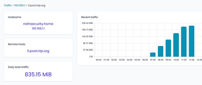

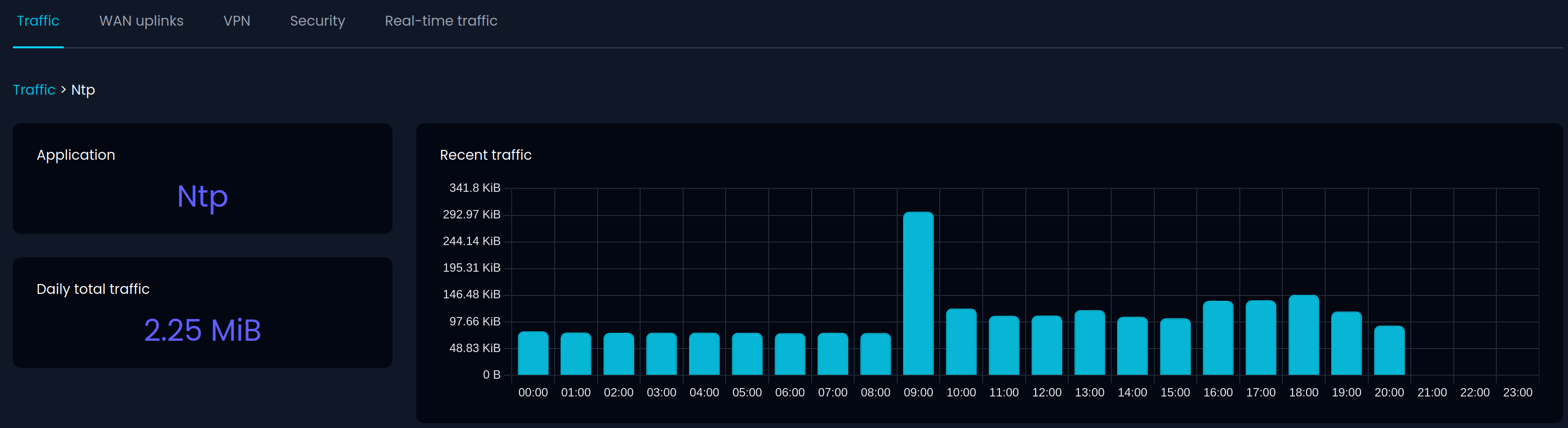

Hugh data consumption NTP in Nethsecurity

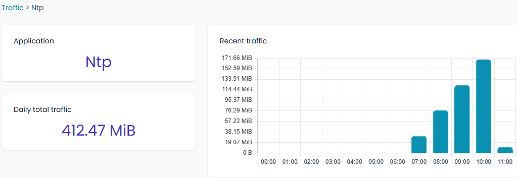

Hello
Is it normal that NTP uses this much data in Nethsecurity ?

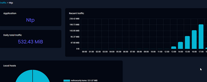

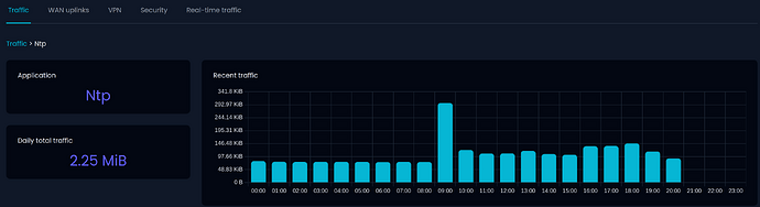

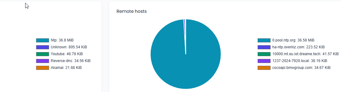

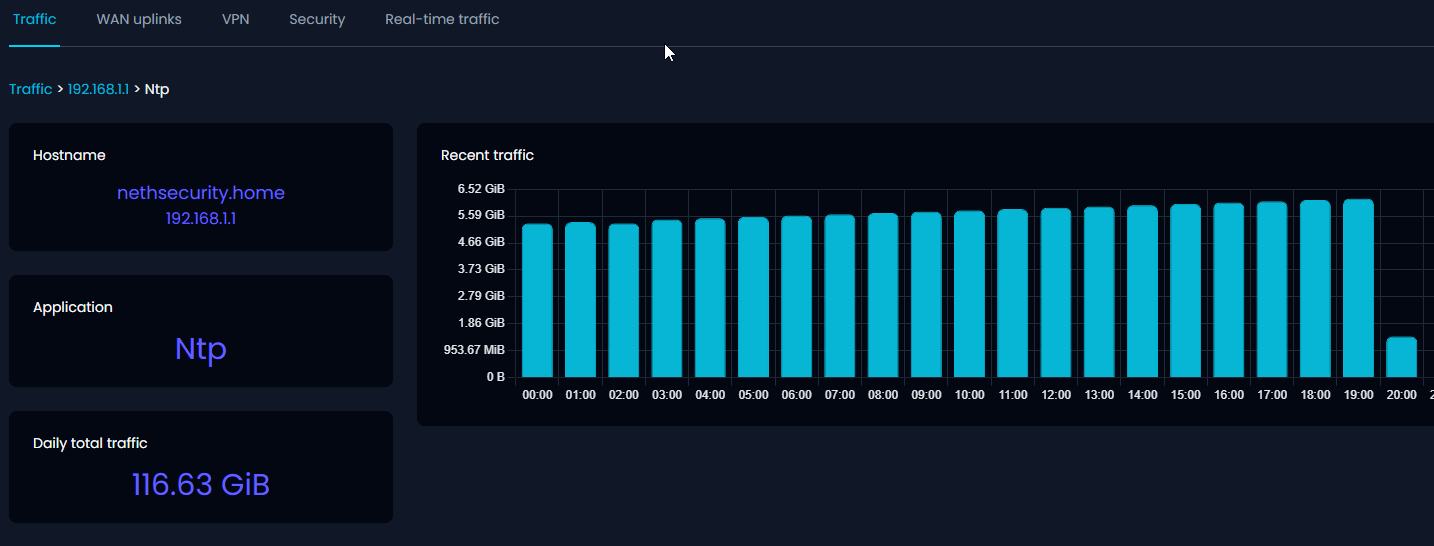

Here’s the complete NTP traffic of my network:
No. Just 1 NethSec.

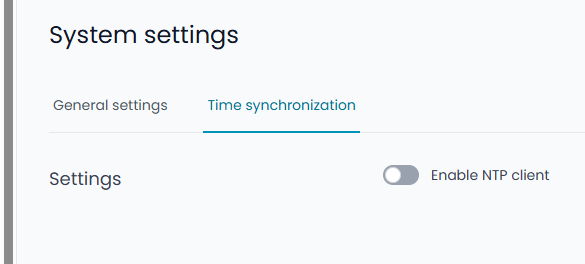

Now disable it for the moment

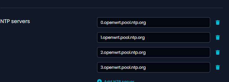

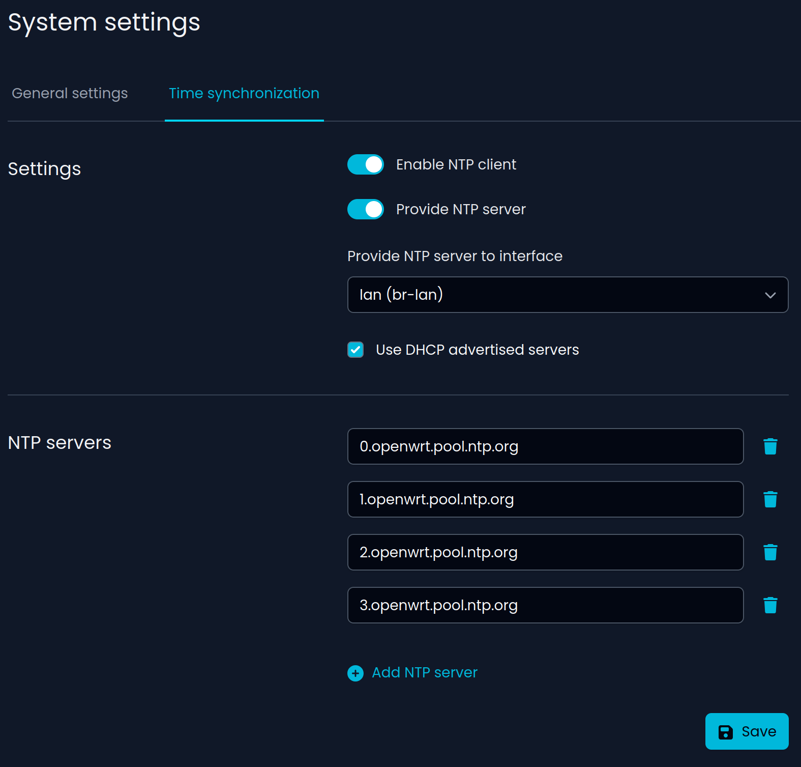

I’m using following NTP settings:

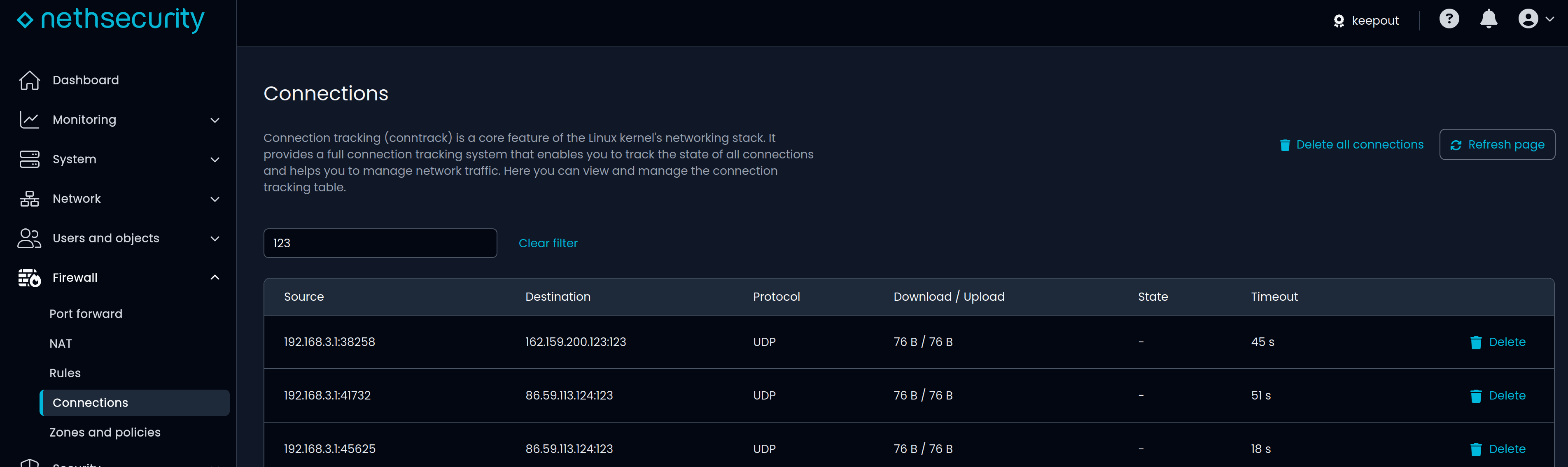

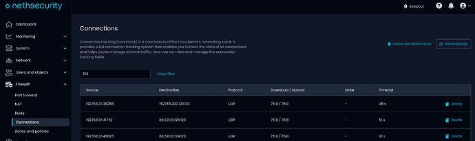

You could check the NTP connections by filtering port “123” to maybe find a faulty device:
Maybe Wireshark can help?
I can see a couple of reasons for this strange behavior:
  • the DPI engine does not recognize correctly that type of traffic for some unknown reason
  • someone or something is using the NTP protocol to do something very strange and maybe malicious

I’ve disable the NTP server and did a reboot.

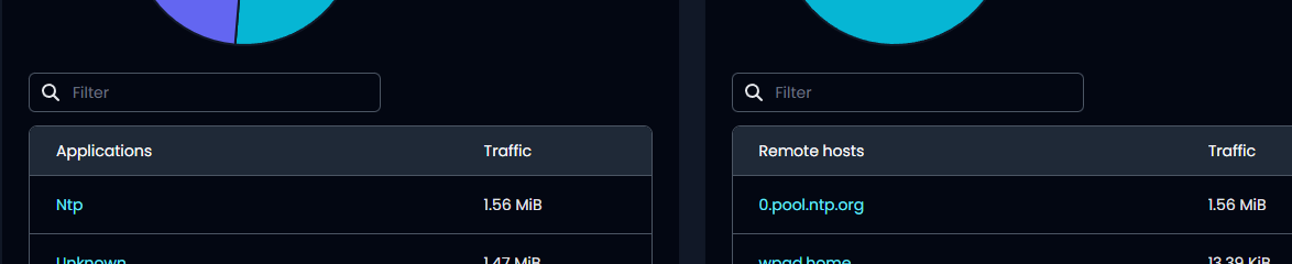

But i see still the NTP 0.pool.ntp.org as traffic

After a reboot is looks less, but it increases in time

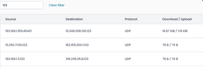

How can i find out what or which IP is using the NTP?
Currently there are no windows PC’s active
It looks coming for 0.pool.ntp.org

Also i’ve NTP disabled now

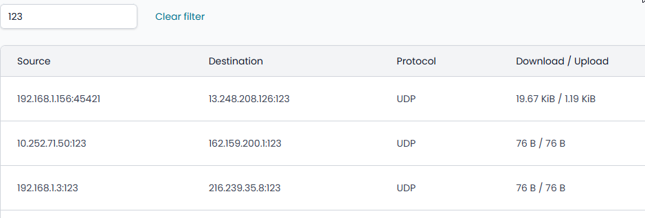

Does it help to check the connections with filtering NTP port 123 as explained here?
No. Unfortunately
It keeps connecting to 0.pool.ntp.org

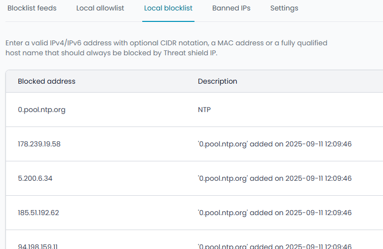

I’ve block this domain in the filter, but it keeps getting connected
I think you need to block it by using rules instead of content filter, see Rules — NethSecurity documentation

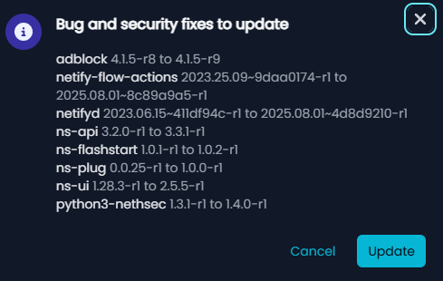

I did a update in the Nethsecurit UI and now it is back

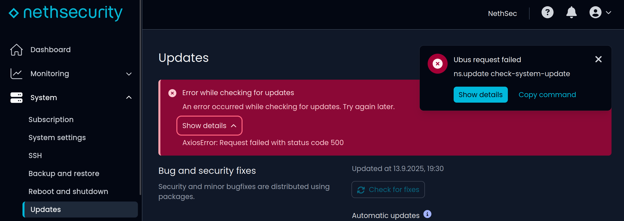

I tried it but I got an error and updates didn’t work anymore so please care about having a backup in case something goes wrong.
I’ve done an manual update.
It look like the problem is in Netify-flow-actions or Netifyd
After this update the NTP increased again. Strange part is that my time synchronization is set to 0.openwrt.pool.ntp.org and the data is coming 0.pool.ntp.org
