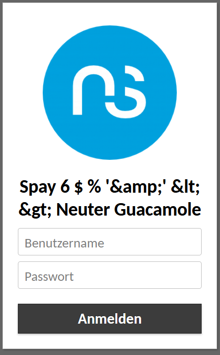

In Browser Console I see following after testing different chars, some are translated to html which is wrong, others are not.
<div class="app-name ng-binding">Spay 6 $ % '&amp;amp;' &amp;lt; &amp;gt; Neuter Guacamole</div>

No, you can change it in browser console but no success:
CSS:
I think the content is escaped/sanitized internally (maybe trough angular.js …) regardless of file encoding
