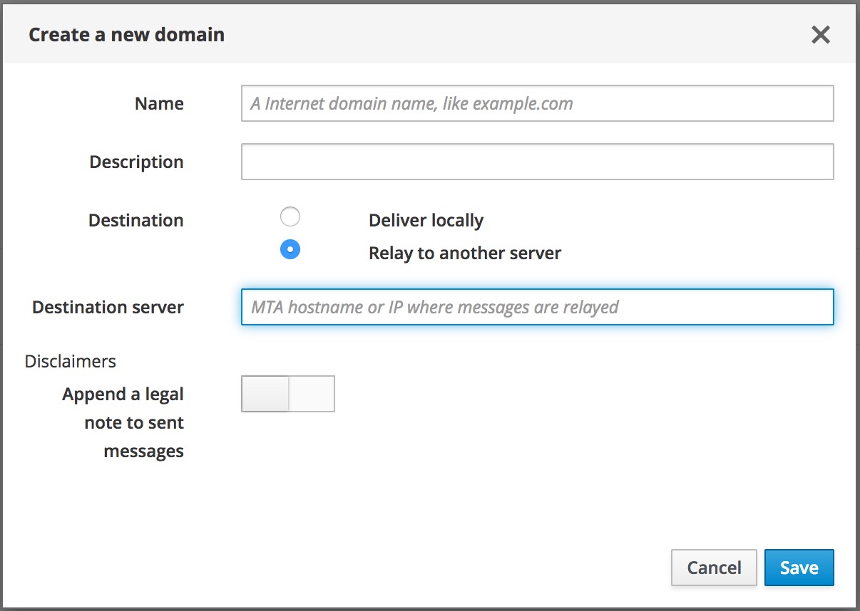

For incoming (From Internet to your local NethServer) there are a few options, most elegant and simplest would be NethServer forwarding mails per Domainname to the specified IP…
