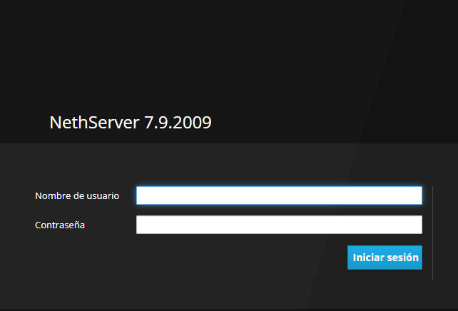

I have created a pull request to modify the login screen
@giacomo @stephdl @dnutan can you try the pr 333?
Update brandings.css by jgjimenez · Pull Request #333 · NethServer/nethserver-cockpit · GitHub

The initial concern was the translation
When applying translations, sometimes they are longer than the English word itself, in my case “Username” is “Nombre de Usuario” and the text box hides the whole word.

I tested the PR https://github.com/NethServer/nethserver-cockpit/pull/333 No changes in my laptop
I am not sure the fix is inside CSS, change the translation, what do you think @edoardo_spadoni

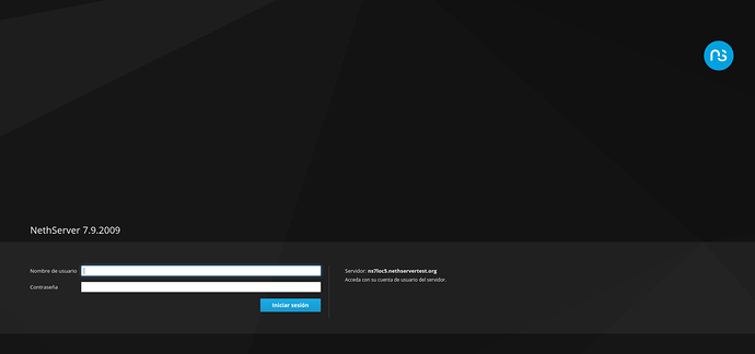

I reverted my changes, and when using my page at 67%, it looks fine, i.e.; the problem is adaptability.

Here I can also use it, already in transifex make that change Nombre de Usuario per Usuario, but I already saw that the problem was not the translation but the size of the screen or the resolution of the graphic, I reduced from 100% to 75% in my browser and it works smoothly. it’s a matter of adaptability
