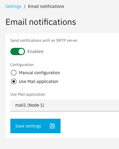

From what I see up-thread, that makes it look like SMTP isn’t configured–but it should be:
Hi @dan
If I’m not entirely mistaken, you still need to configure the SMTP settings within the app itself. To do this, you’ll need to log in to VW as an admin.

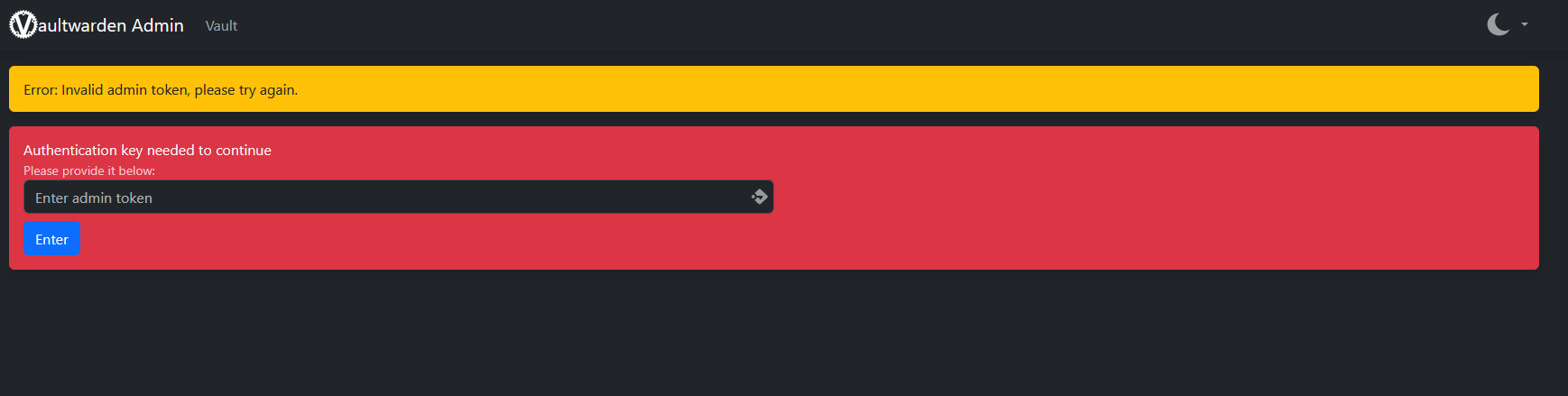

Good morning @kemboielvis22
I have now noticed that I can no longer log in as an admin using the stored password.
The command runagent -m vaultwarden1 cat vaultwarden.env displays the correct password. However, I am unable to log in as an admin via the web console.
Unless you changed the password and forgot about it, there is Def Nothing you can do to recover that key.
I once made a similar mistake. every method to try and retrieve failed miserably, i only had to reinstall vaultwarden, anc copy passwords into the new instance, then delete the previous installation, at least this time around making sure i dont forget my key.
I’ve changed my password. Does that still apply?
Hello Can you check the vaultwarden.env if the smtp credentials have been set
Did you change the admin token
Did you install from version 1 and upgrade to v2 or
