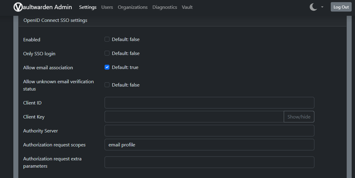

We will be working on adding the recently implement env for SSO implementaiton in vaultwarden, so that you could use it with your authentik instance as well.
I see the SSO setting availabel on the admin UI
However i am not sure if they work without the relavant env configured, maybe you could test and revert..

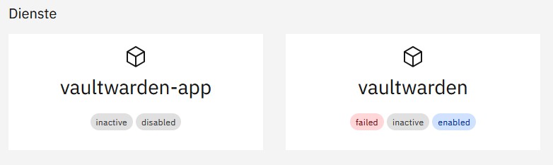

I installed VW, set an fqdn, and requested a certificate. However, apart from a bad gateway, there is nothing to be seen.

However, the settings are repeatedly overwritten when I press Save in the settings.
After editing the vaultwarden.env
run
systemctl --user restart vaultwarden.service
