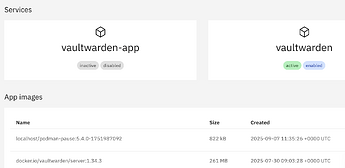

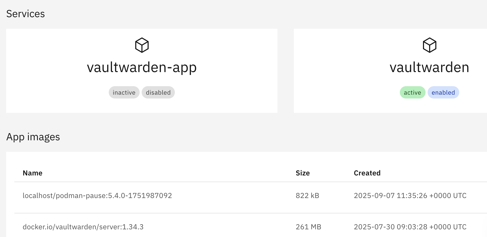

On other app instances I find a way to remove them. Am I missing or not seeing the one for vaultwarden in the status window for Vailtwarden page?
remove module --no-preserve moduleid1 should remove the app you need from CLI

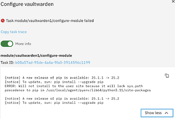

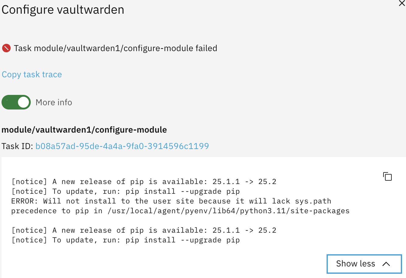

The default admin token provided left alone and hit save:
Going to FQDN: Bad gateway.
vaultwarden ondev branch is not woeking?!! fresh install?
