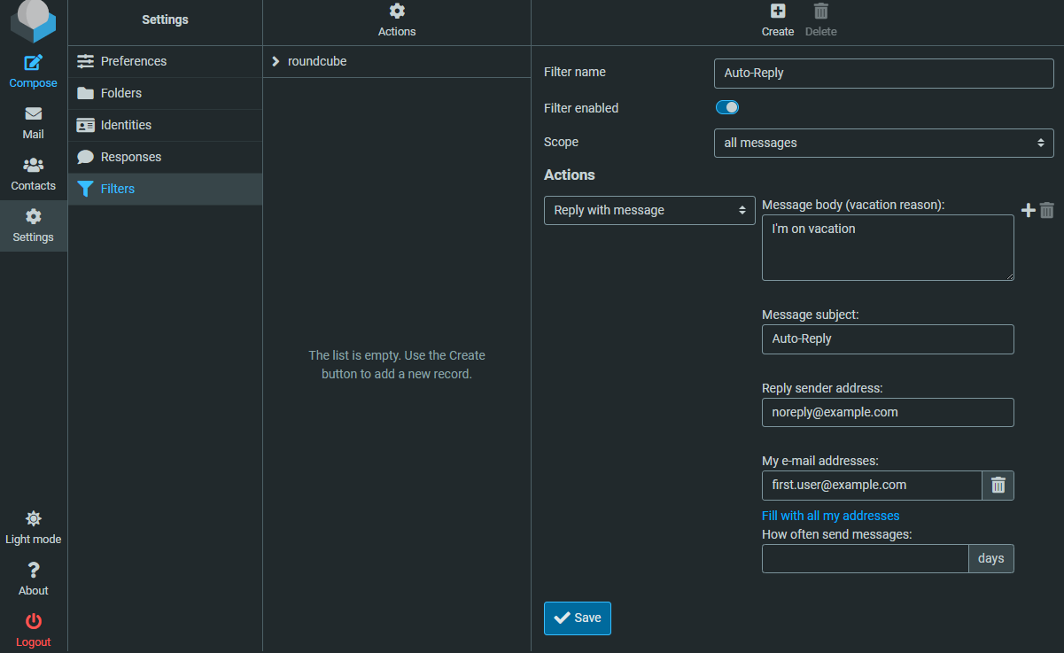

I set up a auto-reply filter. The filter works if I send an email internally, but not when I use fetchmail for delivering the email from the remote server.
Any idea why the auto reply email is not sent? Where or how can I check why this doesn’t work?

Seems it’s a misconfiguration. Sending to from internal Roundcube to an external email address works, but when the sieve vacation action is triggered, the verbose log shows something like
[...] 3A7808203F7: to=<someexternal.user@external.net>, relay=smtp.ionos.de[213.165.67.113]:587, delay=1, delays=0.46/0.01/0.49/0.04, dsn=5.0.0, status=bounced (host smtp.ionos.de[213.165.67.113] said: 550-Requested action not taken: mailbox unavailable 550-Sender address is not allowed. 550 1M6DOg-1vSLHM0tc8-002uGo (in reply to MAIL FROM command))
I currently can’t figure out what the vacation sieve filter sets as sender address. Seems it’s not the “Reply sender address” configured in the filter as this would be a valid address.
The “Reply sender address” is used when set. If it’s not set, the address in the “My e-mail addresses” field is used to send the autoreply.
Are the addresses allowed on the ionos smarthost?
Maybe you need to setup an identity in Roundcube, see also Roundcube vacation / autoreply / out of office email plugin, how to find / enable? - #23 by mrmarkuz

I still cannot figure it out:
  • If I configure the Mail-Relay (of the Nethserver 8 Mail App) with a Default rule (to send every email regardless of domain), I can send out emails (any email with domain example.com) with Roundcube, accepted by Ionos.
    For the vacation filter I configured the same email address as the internal address, first.user@example.com for “Reply sender address” and “My e-mail addresses”.
    But Ionos refuses the auto-reply email with
Dec  2 11:12:28 postfix/smtp[581]: D54539446A4: to=<test@external.net>, relay=smtp.ionos.de[213.165.67.97]:587, delay=0.58, delays=0.09/0.01/0.45/0.03, dsn=5.0.0, status=bounced (host smtp.ionos.de[213.165.67.97] said: 550-Requested action not taken: mailbox unavailable 550-Sender address is not allowed. 550 1N95mR-1wBGOp1pbz-00sxVn (in reply to MAIL FROM command))
  • If I configure the NS8 Mail-Relay to only send for example.com, I can send out mails with Roundcube (like above), accepted by Ionos.
Dec  2 11:08:14 postfix/smtp[463]: 37E29948454: host mx01.ionos.de[217.72.192.67] refused to talk to me: 554-kundenserver.de (mxeue103) Nemesis ESMTP Service not available 554-No SMTP service 554-Invalid DNS PTR resource record 554 [...]
So it seems the auto reply email has a different domain configured for the sender (not example.com).

Usually it should be the same sender address as for the internal vacation mail.
You could use the sieve-test command to check the used sender mail address.
Enter dovecot container:
runagent -m mail1 podman exec -ti dovecot sh
Create test mail (just copy the source of a sent testmail into the mailfile file)
vi mailfile
Execute test:
sieve-test first.user/sieve/roundcube.sieve mailfile
In the result you should see the sender address of the vacation mail:
Performed actions:
 * send vacation message:
    => seconds : 604800
    => subject : Auto reply
    => from    : noreply@example.com
Thank you @mrmarkuz !
As expected, the filter works as configured (and is working for internal email), this is the result.
