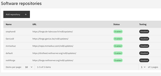

Also it seems like the testing repos and option to enabe or disable them has been disabled.
is this a bug, an overlook or by design?
Yes, the process is still manual. Nethbot will learn how to do it automatically, but nobody has taught it yet. So, for now, I’m still writing the announcements by hand while replying here.
Nice catch, Martin. This is by design. I’ll explain it in the release notes. In short, you can now update to a testing version only from an existing instance card. Check the three dots menu for that option.
The update action is displayed only when a testing version is available.

I think this design is ok for ‘official repo’s’ and level 3 and up certified apps, but not for other repo’s and level 2 and down apps. Testing new versions of 3rd party apps becomes way much more difficult and requires cli skills, commands, outside GUI actions and thus mistakes,
I would opt for a seperation of official/certified apps fron default and nethforge repo’s but NOT for all other apps/repo’s. It would limit the ease of use and scare testers away if testing 3rd party apss is being made difficult (read cli).
Also being able to enable the testing repo provides the opportunity see be alterted and see if there are new testing versions available. By removing the testing repo, this possibility is gone.
I believe it would be fair if subscription based servers are a little more restricted to safeguard functionality and protect Nethesis commercial services, but not community driven and maintained servers.
So please put ‘restrictions’ on certified apps but uphold the freedom to test and see watever one wants. I believe I mentioned before that ‘overprotecting’ or ‘over regulating’ leads to limitations of freedom. A bit like what the EU is doing :wink:

@LayLow you are correct, it makes testing harder, even for those with clie skills, since one of the reason we started publishing alpha apps, was so that its easy to install test, report issues, then we fix and push update
Our testing cycles do not ussually involve one app, but multiple at the same time, so by the time 4 hours windo has elapsed, and updates have been pushed to git, someone gets the fresh updates for testing.
We test ussually both fresh isntall and update cycle…

We have fewer than 1 testing versus over 1000 users running production servers. The cluster-admin UI is designed for sysadmins, not developers. For developers, consider that:
  • add-module ghcr.io/myrepo/myapp:mytag is a simple command to install a testing version.
  • Testing an upgrade can be done directly from the UI. In some rare cases a testing release contains an hotfix. In those rare cases a sysadmin may need to quickly install it from UI.
