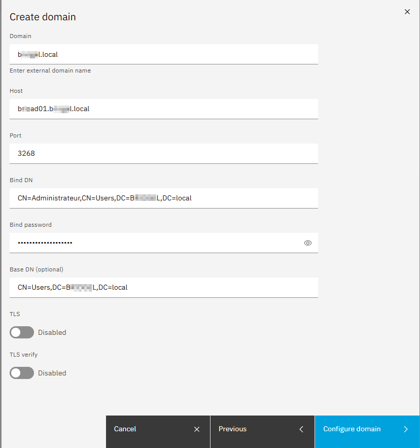

Could you please share a screenshot of the external AD you configured in the NS8 cluster admin just to check if you entered domain name/netbios name, upn or user name, base dn empty or not etc.
Are there special chars in the usernames or some non-standard naming convention?
