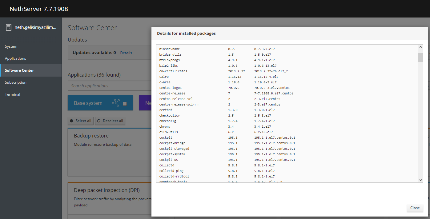

When I go to software center it is not listed in there and I failed to find a way to make installed applications visible. So I think it is not possible to remove an application from Software Center.

Is Cockpit up to date? Check it in Software Center.
I do not have any updates displayed in there.
