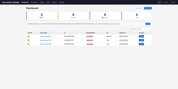

Added

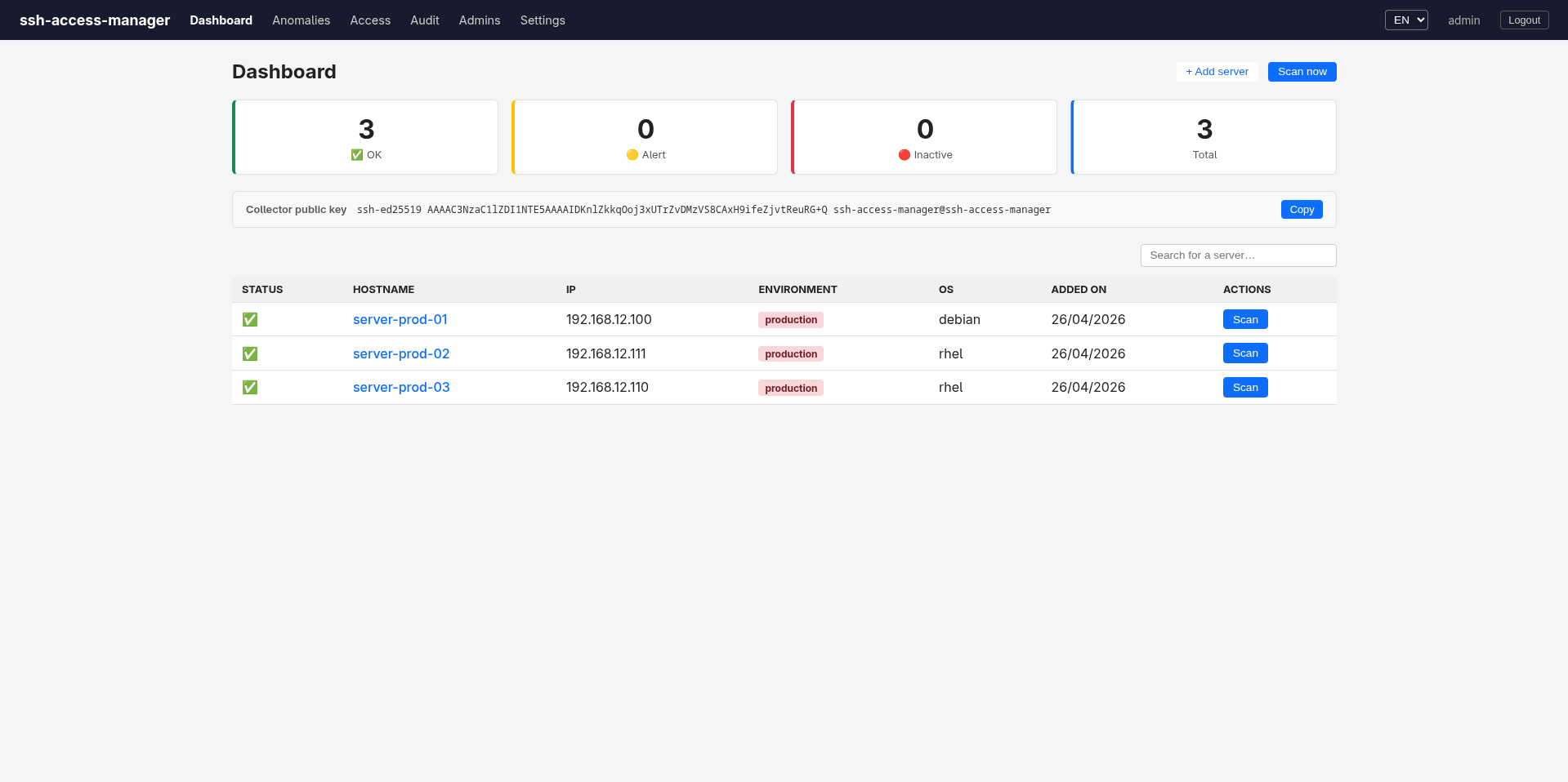

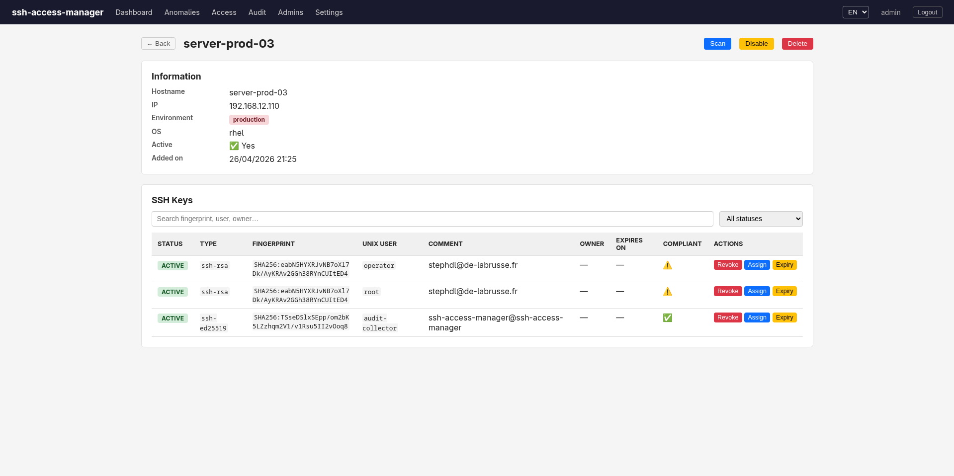

  • Centralized web interface to view SSH authorized_keys across all managed servers

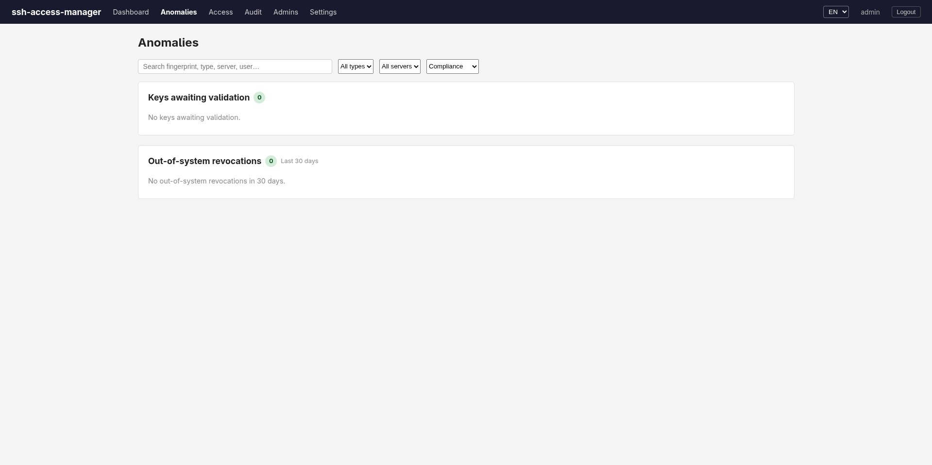

  • Anomaly detection system:
    • Detects keys added or removed outside the platform (e.g. ssh-copy-id, manual edits)
    • Generates critical alerts on unexpected changes
  • ANSSI BP-099 compliance checks:
    • Flags weak SSH keys (RSA < 4096 bits)

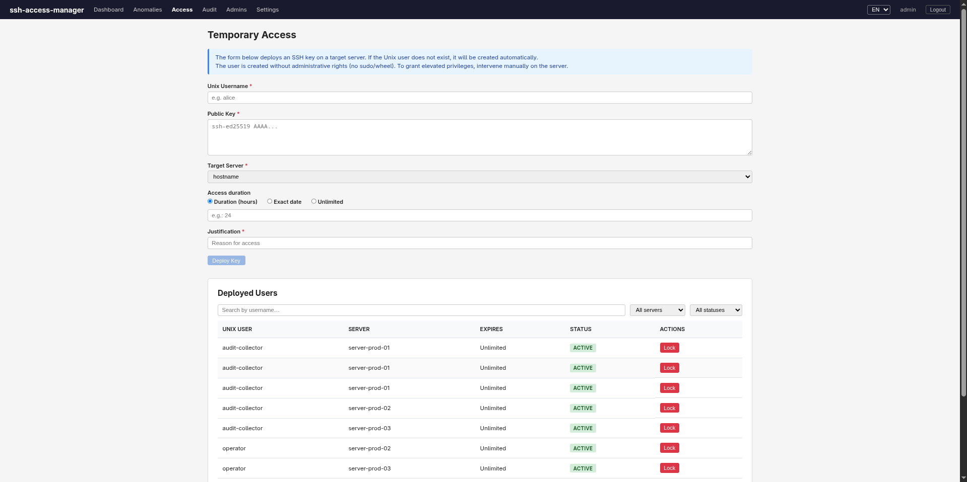

  • SSH key lifecycle management:
    • Key creation with expiration date
    • Mandatory justification field
    • Automatic key revocation at expiry

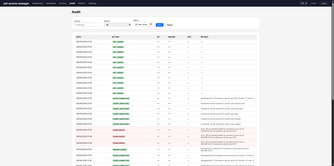

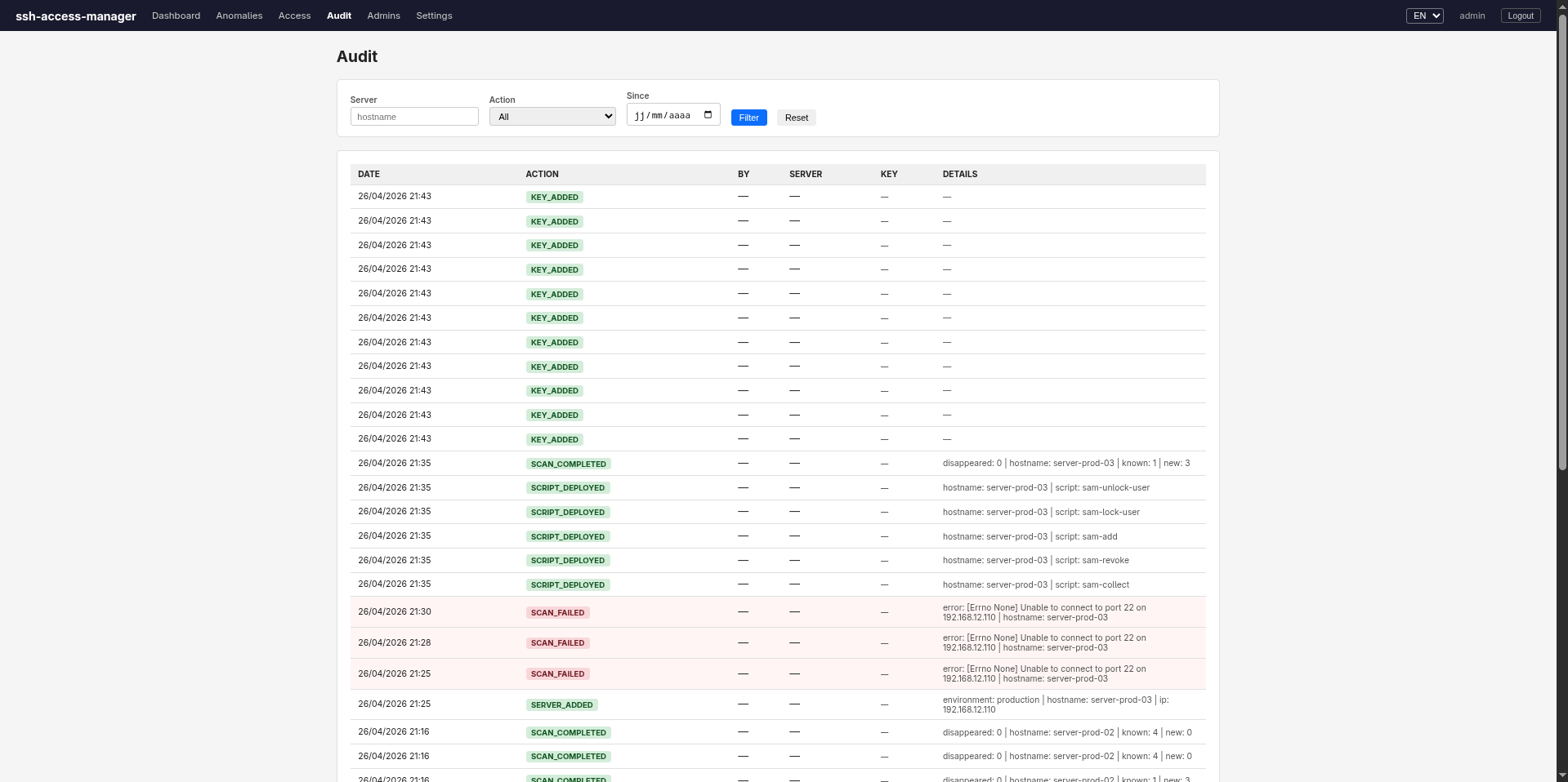

  • Audit logging:
    • Tracks key additions, revocations, and script deployments
  • Automated provisioning system:
    • Remote deployment of audit scripts
    • Idempotent server setup

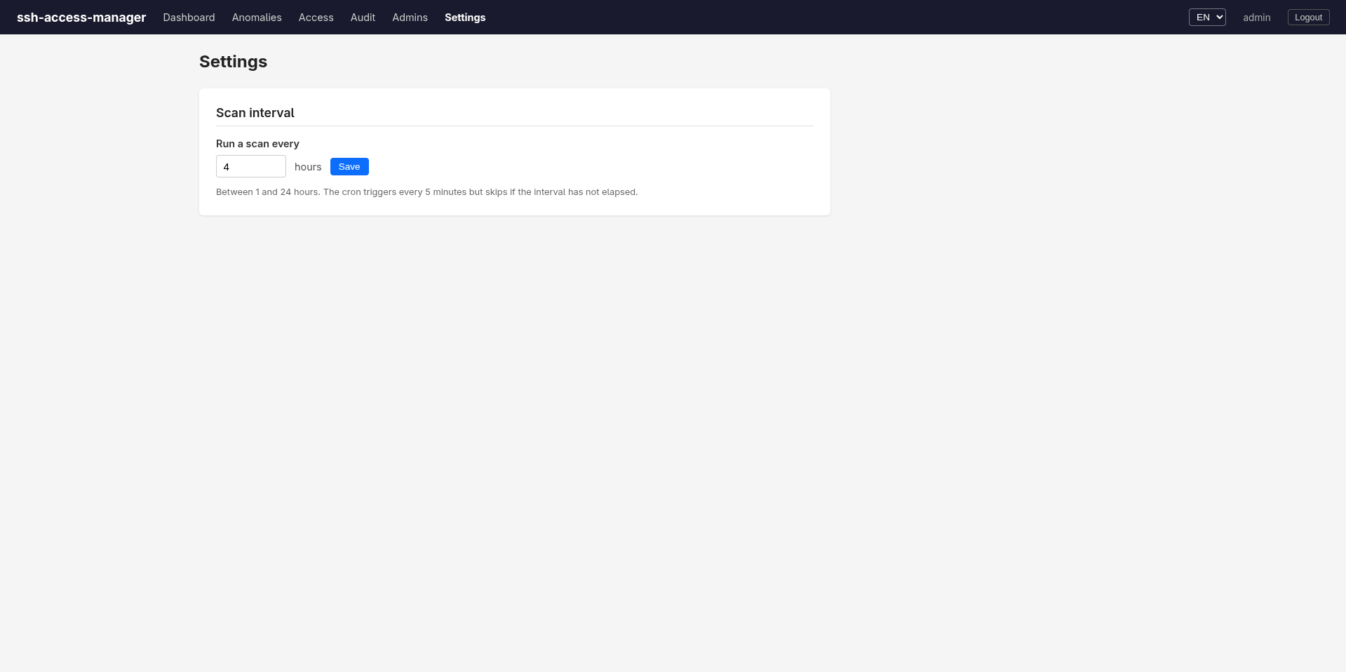

  • Periodic background scans with configurable interval
  • Ability to manage SSH keys on the host running the module itself

runagent -m sam1 ../bin/provision-server \
  --hostname server-prod-01 \
  --ip 192.168.1.100 \
  --user root \
  --env production \
  --os rhel

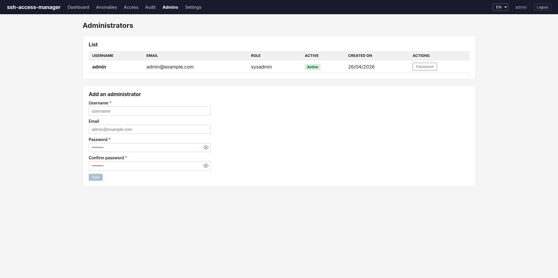

anyway I dropped a lot of enhancement yesterday night, now we have a RBAC, role based access control for 3 roles, a timeout when you are logged and a keep me logged function, many setting directly in the setting page, notification are sent to admins (you can disable notifcation for a specific admin) and you have a button to test your smtp settings for notifications.
for now I have comments and documentation in french because it is a project for my VAE but I have to translate them in english.
what to say more SAM can be used as a standalone project but ns8 will ease the work to run the container, to backup it and to provision a remote host

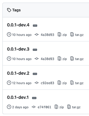

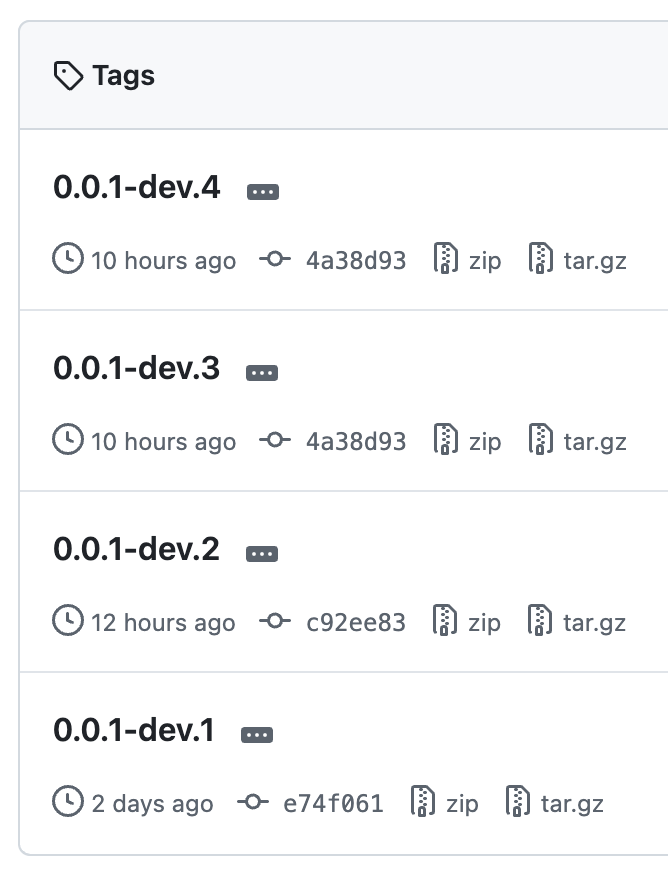

JFY the readme says “remove-module --no-preserve sam1” but it should be:
remove-module --no-preserve ns8-ssh-access-manager1

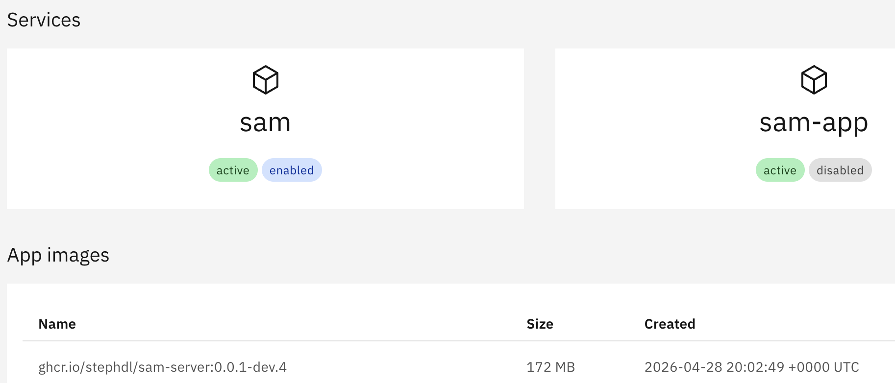

and what version is the latest as we speak?
ps. I used the latest which seems to install:
you can use the application or the software page to remove :smiley:
you are right : 0.0.1-dev.4
