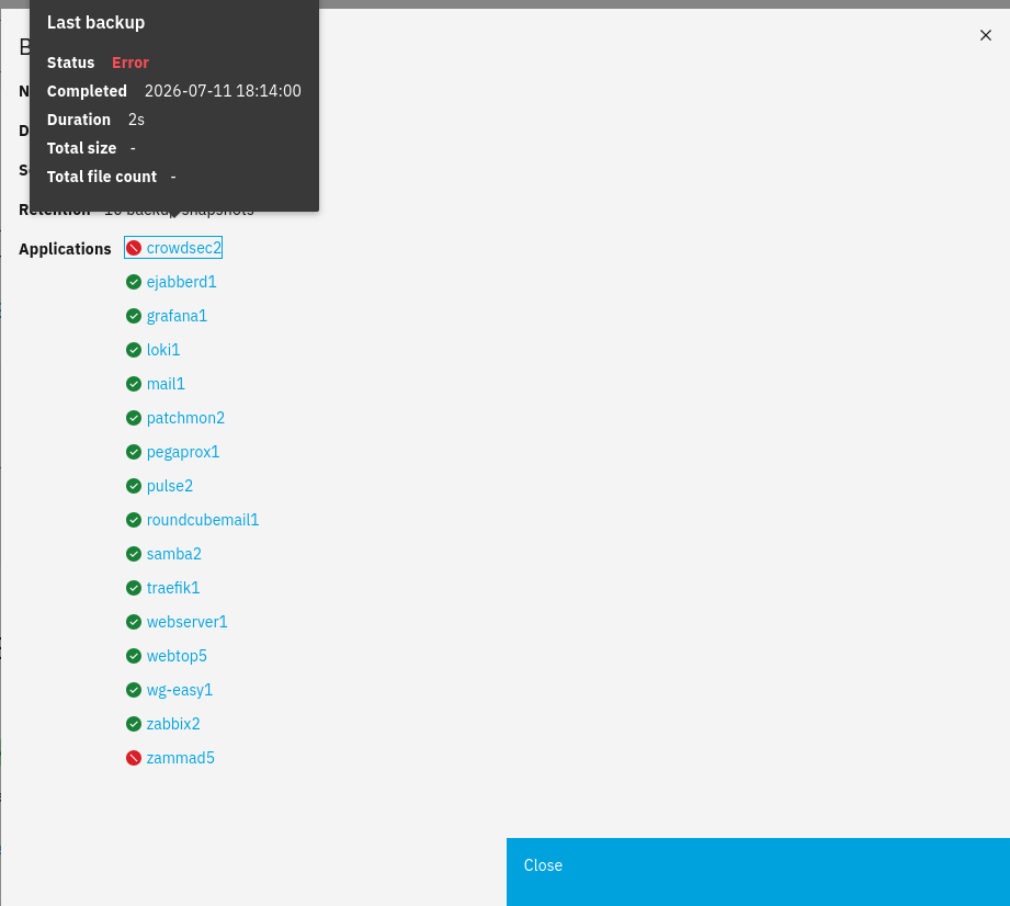

Got a error message: Some backups failed - Check out ‘Schedules’ below
Backup no longer working for Crowdsec. Looked at settings in Crowdsec. Everything seemed ok. Remove backup and created a new one. I removed Crowdsec and created a new one.
@mrmarkuz - Any ideas what is causing Crowdsec not to backup? How can I get Crowdsec backing up again?
Thanks

There’s an issue regarding rootfull modules like crowdsec or dnsmasq, see Backup Error dnsmasq to SMB-Share
Thanks for seeing this and letting me know.
Hmmm… says
Steps to reproduce
Install Core 3.20.0 and Dnsmasq
Schedule a backup that includes Dnsmasq
Run the backup from the UI
I don’t have Dnsmasq installed. I am guessing there is no fix yet?
mrmarkuz
(Markus Neuberger)
July 11, 2026, 8:33pm
4
It’s the same for crowdsec.
Right, you can check the issue here
