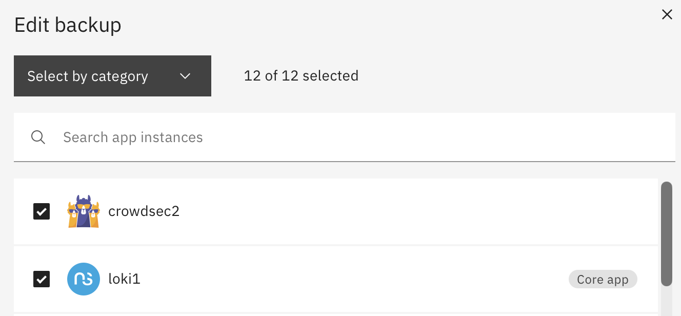

I recently added a crowdsec module then added it to an existing backup :
When lauched from the UI, it fails :
