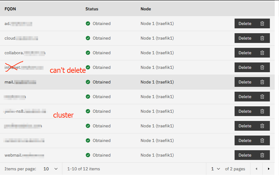

About 2 months ago I posted about not being able to delete a certificate for a domain that was created in error. I could never get that certificate to delete. So now I see from the error messages that this domain is causing the “error renewing certificates”.
Since that intranet.domain.tld is referenced through the other domains nothing updates.

It looks like its looking for intranet.domain.tld but since I removed it from my DNS, it isn’t working. So adding these back to both local and external DNS.

This removed the intranet.domain.tld temporarily from the console GUI. The GUI shows intranet.domain.tld as not obtained. Then I tried to do the delete from the GUI but it still doesn’t work. And when it refreshes, the intranet.domain.tld is back … aaaaaahhhh :unamused: HELP!

And now there is no wrong domain in the console GUI. Woo hoo!
