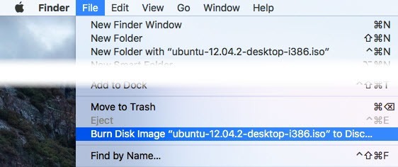

Those weren’t the instructions. The instructions were, “click on .iso, go to File menu, select burn Disk Image (filename) to disk”.
No, absolutely not. In no way, shape, or form do you mount the disc image on your Mac and then burn from there.

But the Finder method works:
Mark ISO Image in Finder
Go to files menu, at bottom select “burn Disk Image (filename) to disk
