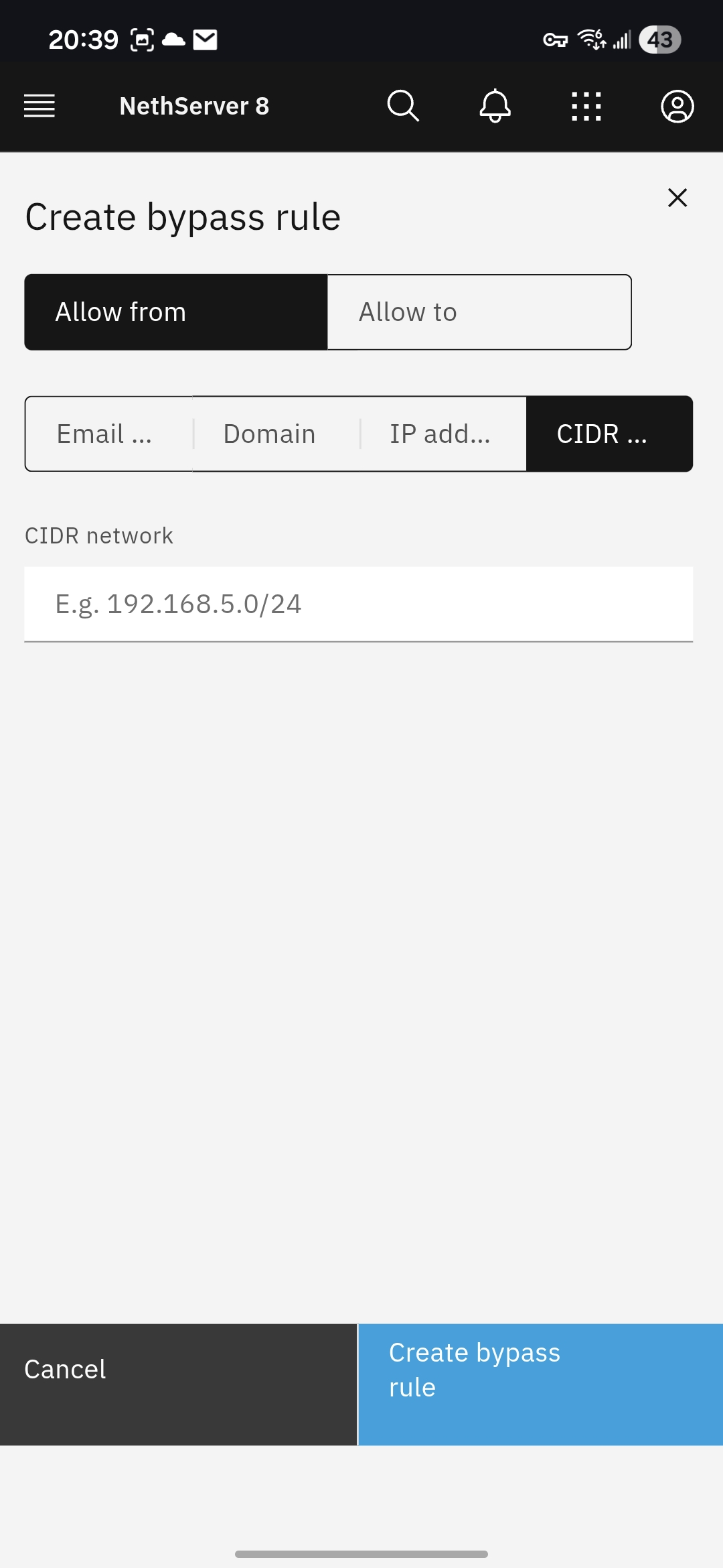

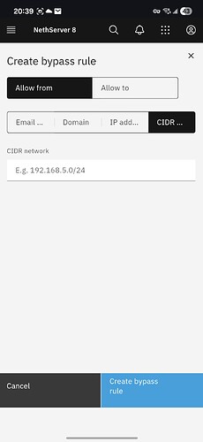

create bypass rules in the filter menu ?
I will try although that seems like a very general way bypassing all for the specified entity. I would have liked to add it to the trusted_networks to prevent the ONCE_RECEIVED_STRICT rule from being hit.
