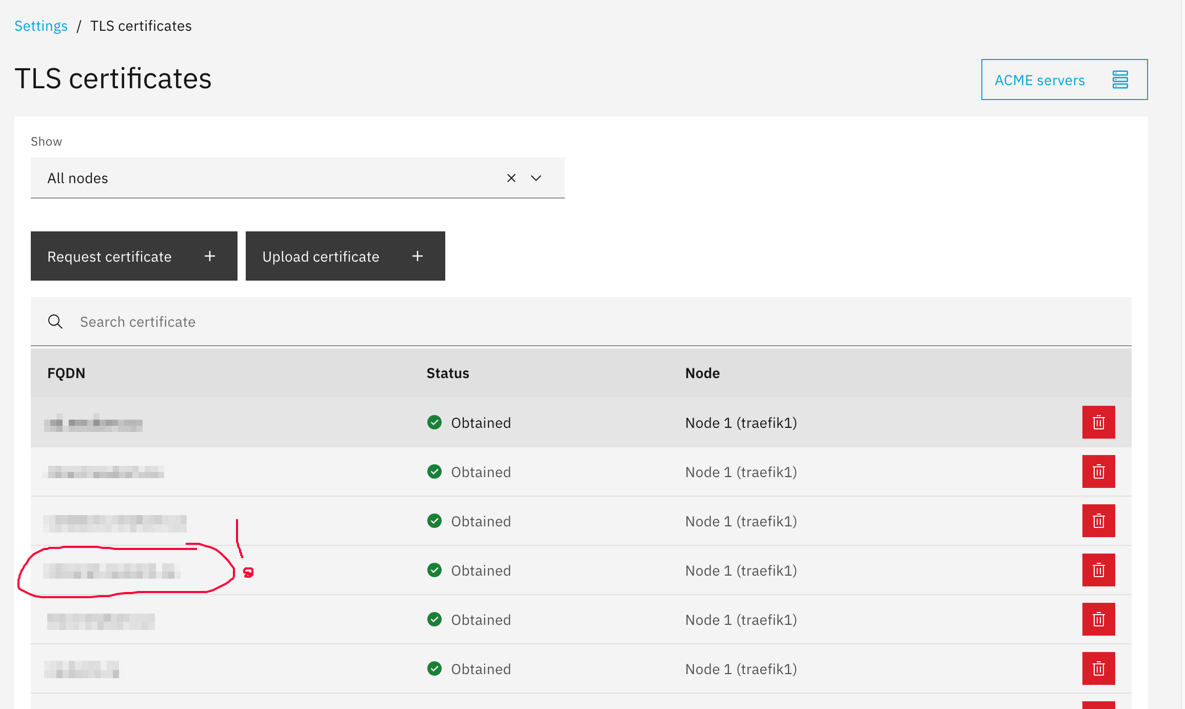

BTW, I’ve tried to delete one certificate that I no longer need as I created a new FQDN for webmail. Each time I try to delete that certificate from the GUI, it processes and then gives an error.
Task module/traefik1/delete-certificate failed
<3>Timeout after about 30 seconds. Certificate not obtained for
… full list of FQDNs

I opened the certificate in the console admin using another browser so I didn’t need to worry about the cache perhaps keeping the old view. The old certificate is still there and when I try to delete, it still gives the same error. :frowning:
Task module/traefik1/delete-certificate failed. I think this just isn’t deleting from the admin GUI or is still in a list somewhere that is used for the display. Perhaps I have to manually edit something?

So I’m not sure why I can’t delete the certificate. I guess it isn’t causing any issues but it would be nice to clean it up.
What’s the result when deleting the certificate on CLI? Adapt “mail.domain.tld” to the domain name of the cert you want to delete.
api-cli run module/traefik1/delete-certificate --data '{"fqdn":"mail.domain.tld","type":"internal"}'

Hi @mrmarkuz
When I run from the cli
# api-cli run module/traefik1/delete-certificate --data '{"fqdn":"delete.domain.tld","type":"internal"}'
Warning: using user "cluster" credentials from the environment
<3>Timeout after about 30 seconds. Certificate not obtained for [...'**list of many different subdomains but not the one I wanted to delete**' ].
<3>
false
When I ran the above command, a window popped up in the cluster admin GUI that said
Task cluster/delete-certificate failed
Task ID: lots of numbers
<3>Timeout after about 30 seconds. Certificate not obtained for [... subdomain list excluding the one I'm trying to delete ...]
<3>
Strange the certificate wasn’t in the list but shows up in the GUI list.
Running
runagent -m traefik1 cat configs/_default_cert.yml
and the delete.domain.tld is found in the list of certificates.
It’s in the list but won’t delete.
