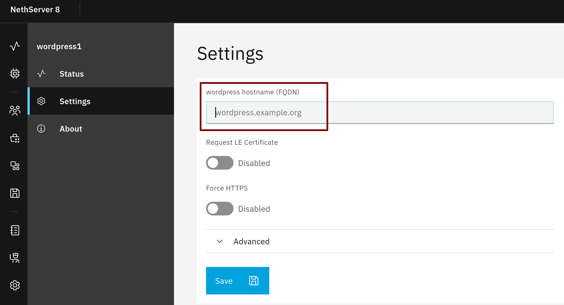

One more quick (related) question, if I run mulitple Wordpress apps for multiple sites, I would need to use http routes? Or could both sites point to the same worker node via DNS?
In the NS8 Wordpress instance app settings you setup a FQDN for the instance over which it is reachable.
So both is possible, both sites FQDNs can point to the same worker node via DNS or you could setup http routes on the leader for both sites via the FQDN as host.
