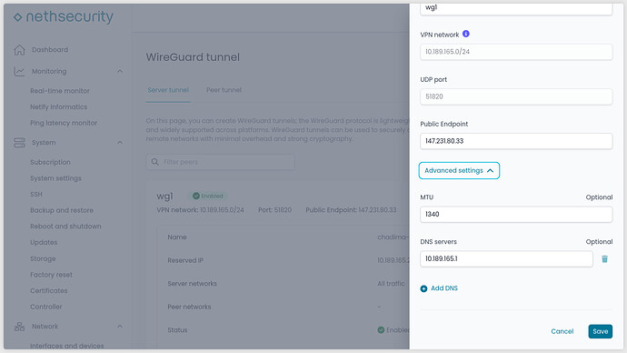

Wireguard MTU not propagated to clients configuration files
If the MTU parameter is filled in WireGuard tunnel → Edit tunnel → Advanced settings
the expected behavior is that the generated configuration file for a peer should contain the MTU.

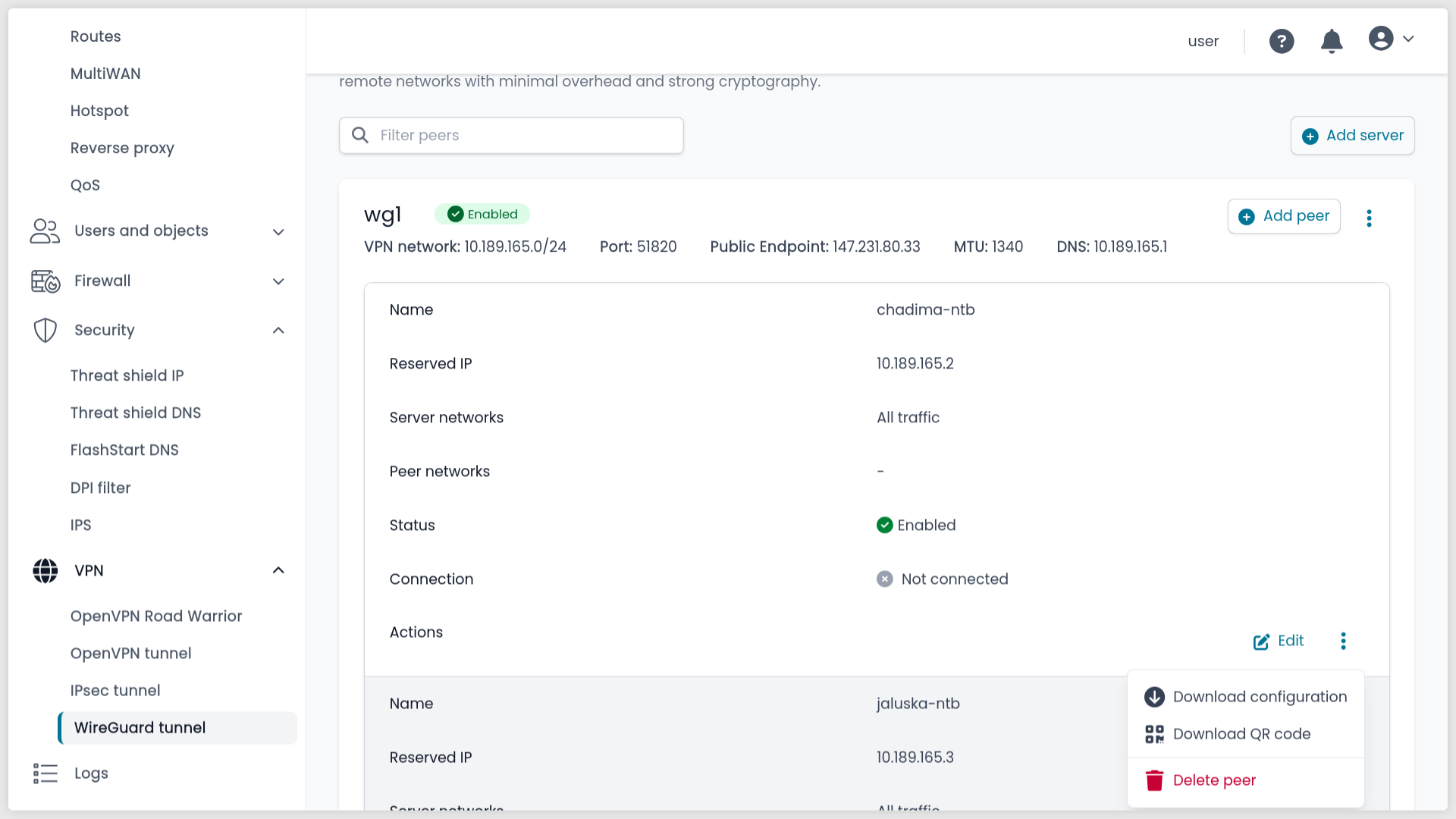

Wireguard tunnel → Download configuration:
But the downloaded configuration file lacks the MTU parameter:

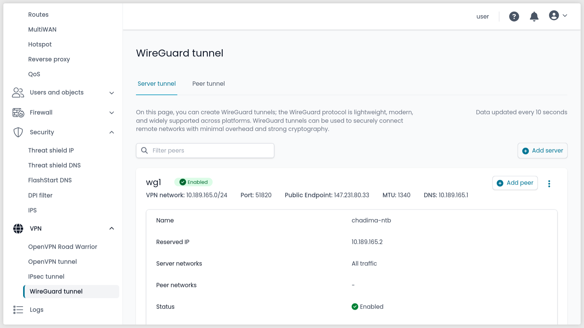

actually the MTU value is added to the Wireguard device on the server side of the tunnel
config interface 'wg1'
        option proto 'wireguard'
        option private_key 'xxx'
        option listen_port '51820'
        option ns_network '10.189.165.0/24'
        option ns_public_endpoint '147.231.80.33'
        option ns_name 'wg1'
        option disabled '0'
        option ns_type 'server'
        option mtu '1340'
        list addresses '10.189.165.1/24'
        list ns_dns '10.189.165.1'
ifconfig wg1 | grep -i MTU
UP POINTOPOINT RUNNING NOARP  MTU:1340  Metric:1
