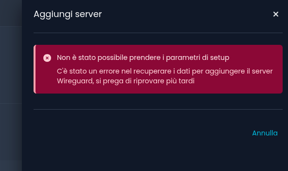

Hi everyone, I’d like to configure WireGuard VPN on a device I just updated to version 8.7.1, but I’m getting this error:
Unable to get setup parameters
There was an error retrieving the data to add the WireGuard server. Please try again later.
OpenVPN RoadWarrior server is working properly.
A possible problem while upgrading from a previous version?
This is a 6-port firewall device with an Intel N150 processor, purchased online.
Thanks for any suggestions.
