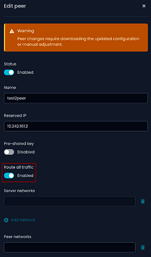

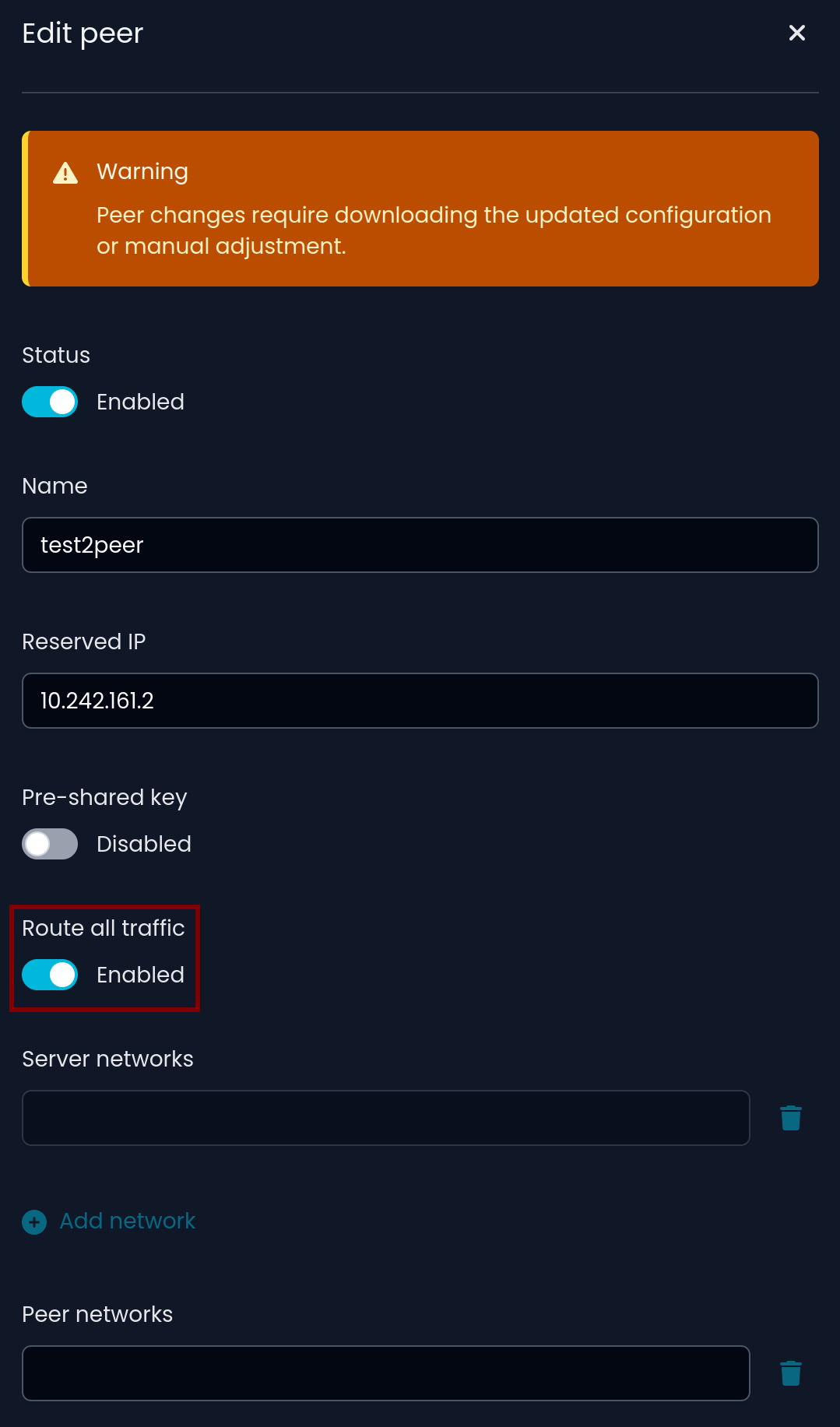

I could reproduce it when “Route all traffic” is enabled in the peer. Can you confirm?
Exactly
Thanks, I filed a bug.
