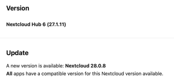

What version IS installed? Nextcloud version showed within Nextcloud admin overview. 1.1.6 is the NS8 Module version.
Actually is Hub 6 (27.1.7)
The current version available is 27.1.11

It is the last release of version 27 (hub 6), which entered EOL this week.
As such, it is the last release of Nextcloud for ns7.
We’re releasing it in the next days for both ns7 and ns8, to keep the migration working.
Then ns8 will step into NC 28 hub 7.

Just upgraded an existing NS8 installation:
Enabled testing in default repo
Update Nextcloud1 instance
Disabled testing repo in default
All seems to run fine. No issues in the logs, but some on the admin page:
@mrmarkuz I did not test OnlyOffice integration yet.
Done and completed with the same results as @LayLow describes.
