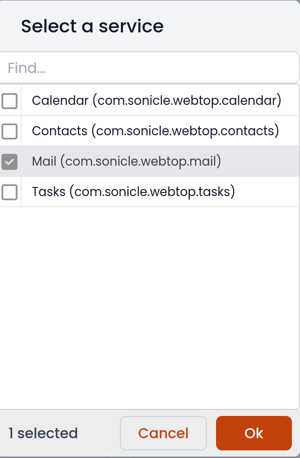

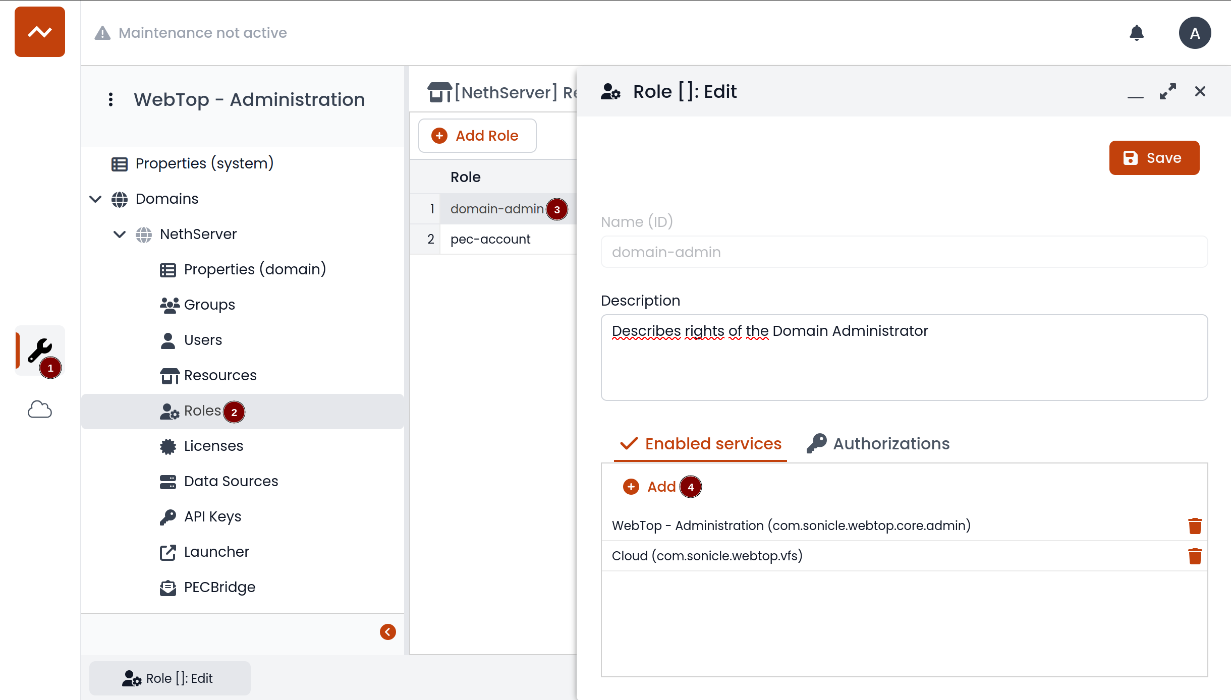

I found that the mails are shown as domain admin, when the mail service is added to the domain-admin role.
Login as WebTop admin and go to the domain-admin role:
Add the mail service:
:grinning_face: very fine ! That’s the right way ! Thank you very much !
