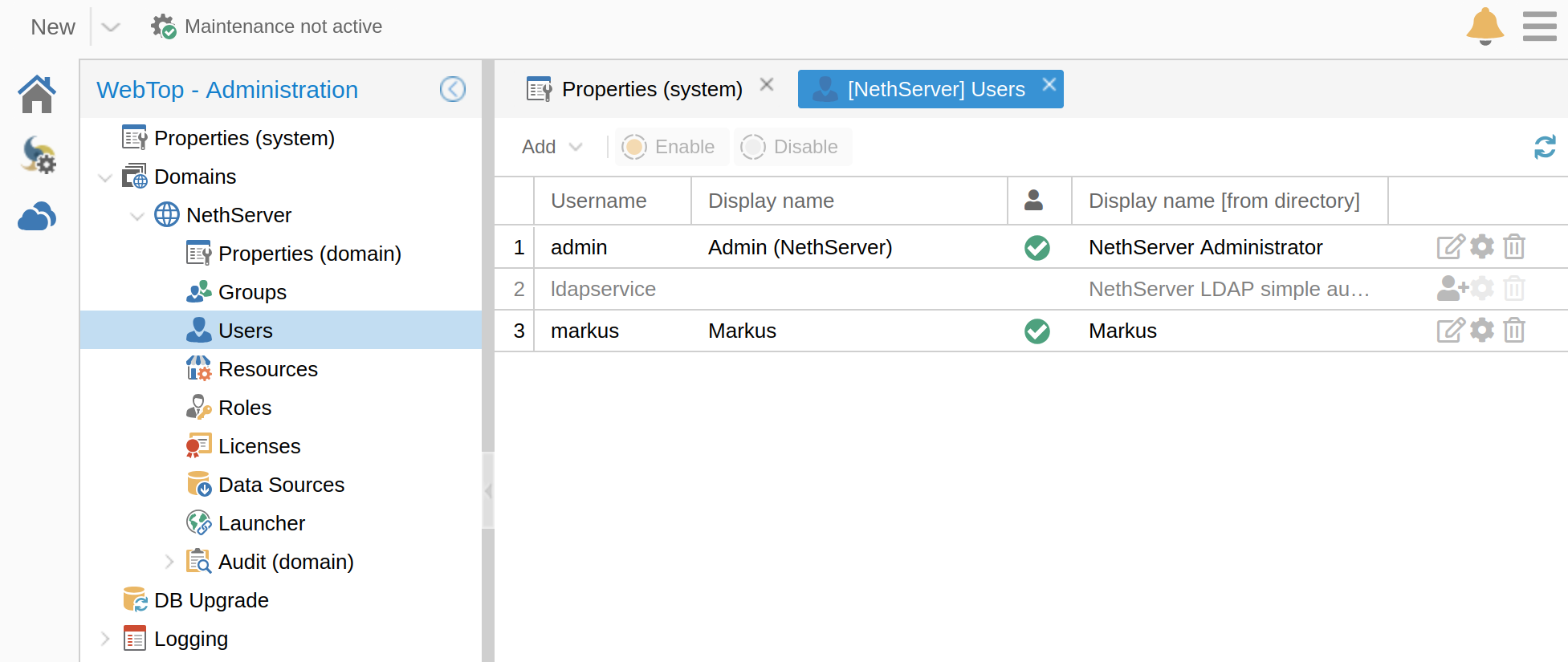

And says Authenticated. The admin for webtop is fine, just any normal user gets rejected. If I reset the user password no change, if I alter the users name it is seen in the webtop user list.
Actions to date
uninstalled the rh-php7xx series, tomcat8 and of coarse webtop5. Nothing has changed the behaviour. Before the re-installations the log had a line that indicated the user had been logged out, before the Webtop screen had loaded.
Am I looking in the wrong log files?
What ID’s are these please? email, username?
@LayLow The users are set in the Server-manager (cockpit) screen as it is supposed to sync via ldap.

In the users list, if I right click on a user the “Change Password” is greyed out. Can passwords only be changed in Cockpit and filter down to Webtop?
Yes, AFAIK the passwords for LDAP users needs to be changed at the account providers users page.
Yes that is my impression too. So as a test I changed a name on an account and it was updated in Webtop. So the flow appears to be working in 1 direction.
I created a new “Test” user, in Webtop the new account appeared after refreshing the users screen. This user still failed to be able to login. Time to turn on a debug log.
So the test user authenticated,so why the login failure popups?
2025-08-26 07:21:10 [INFO ] [webtop][webtop:core] C47D542C92AA46D58AD586B83FC20F1E: client=192.168.35.191 profile=test@NethServer action=LOGIN_SUCCESS
2025-08-26 07:21:10 [DEBUG] [webtop][webtop:core] C47D542C92AA46D58AD586B83FC20F1E: client=192.168.35.191 profile=test@NethServer action=AUTHENTICATED
2025-08-26 07:21:20 [DEBUG] [webtop][webtop:core] C47D542C92AA46D58AD586B83FC20F1E: client=192.168.35.191 profile=test@NethServer action=LOGOUT
Maybe I am looking in the wrong area. According to the audit log the authentication is working. Even rejecting and invalid user name.
Are the users correctly listed on the admin page?
Thanks Marcus,
Yes exactly the same and some accounts are greyed out until you tick the enable button in properties.
The authentication log says all is good so I am thinking it is a webtop acceptance of the login that has failed. Will keep working my way down the Webtop logs with debug set. Hopefully hit gold in the logs soon!!
