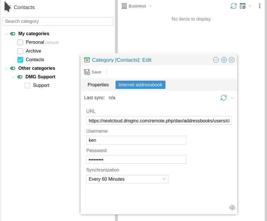

In trying to share the Contacts that are stored in Nextcloud with Webtop, we followed these steps:
  1. In Nextcloud - copy Contact link to clipboard
  2. In Webtop - under Personal calendars - select Add Internet addressbook
  3. In Webtop - paste URL from Nextcloud and provide username/password - click Next
  4. In Weptop - selected Contacts and 60 minute sync interval
  5. Then the name appears in list of addressbooks - BUT NEVER any synced results
Please note that the Contact link in Nextcloud is working on cellphones.
The attached image shows the settings in the foreground and a VERY EMPTY list in the background. Also “Last sync” appears to be “n/a”.
Ideas? Where to look?

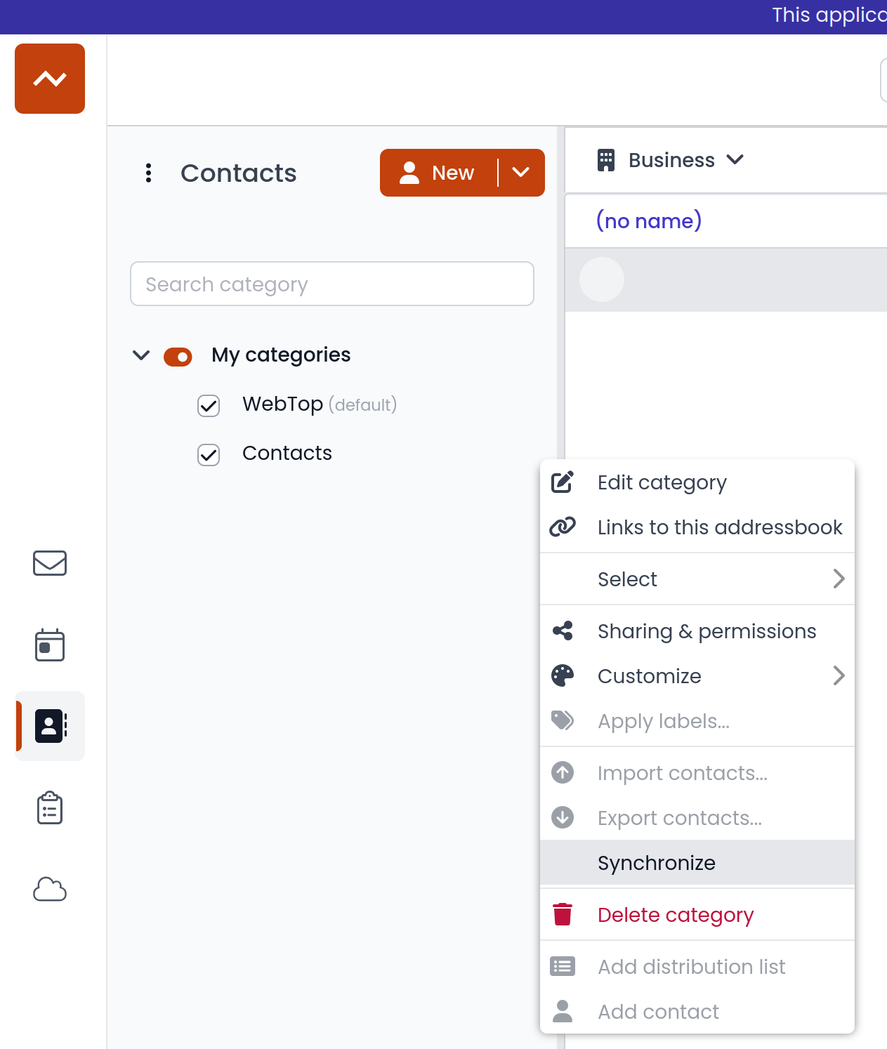

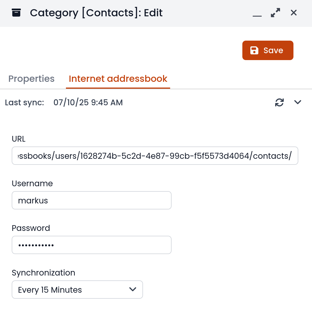

Thanks, I think you found a bug as it seems the automatic sync doesn’t work. It worked after waiting some more time…
I copied the contact link from Nextcloud…
https://nextcloud.ns8rockytest2.com/remote.php/dav/addressbooks/users/1628274b-5c2d-4e87-99cb-f5f5573d4064/contacts/
…and created an internet addressbook in Webtop.

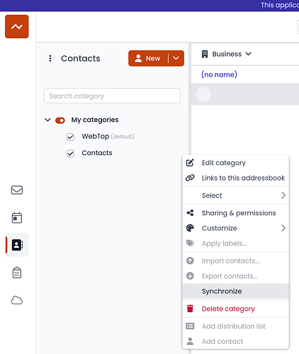

After a manual sync…
…Webtop shows:
But the automatic sync isn’t executed at all.

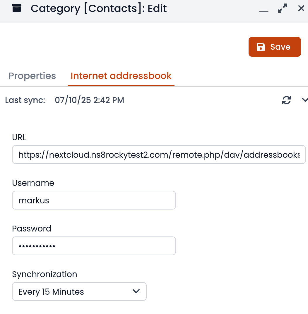

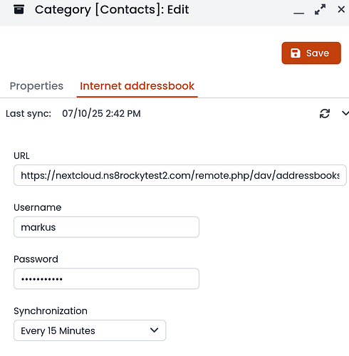

I retried using 15 minutes interval and an automatic sync worked.
So it seems to work, I was just too impatient…
