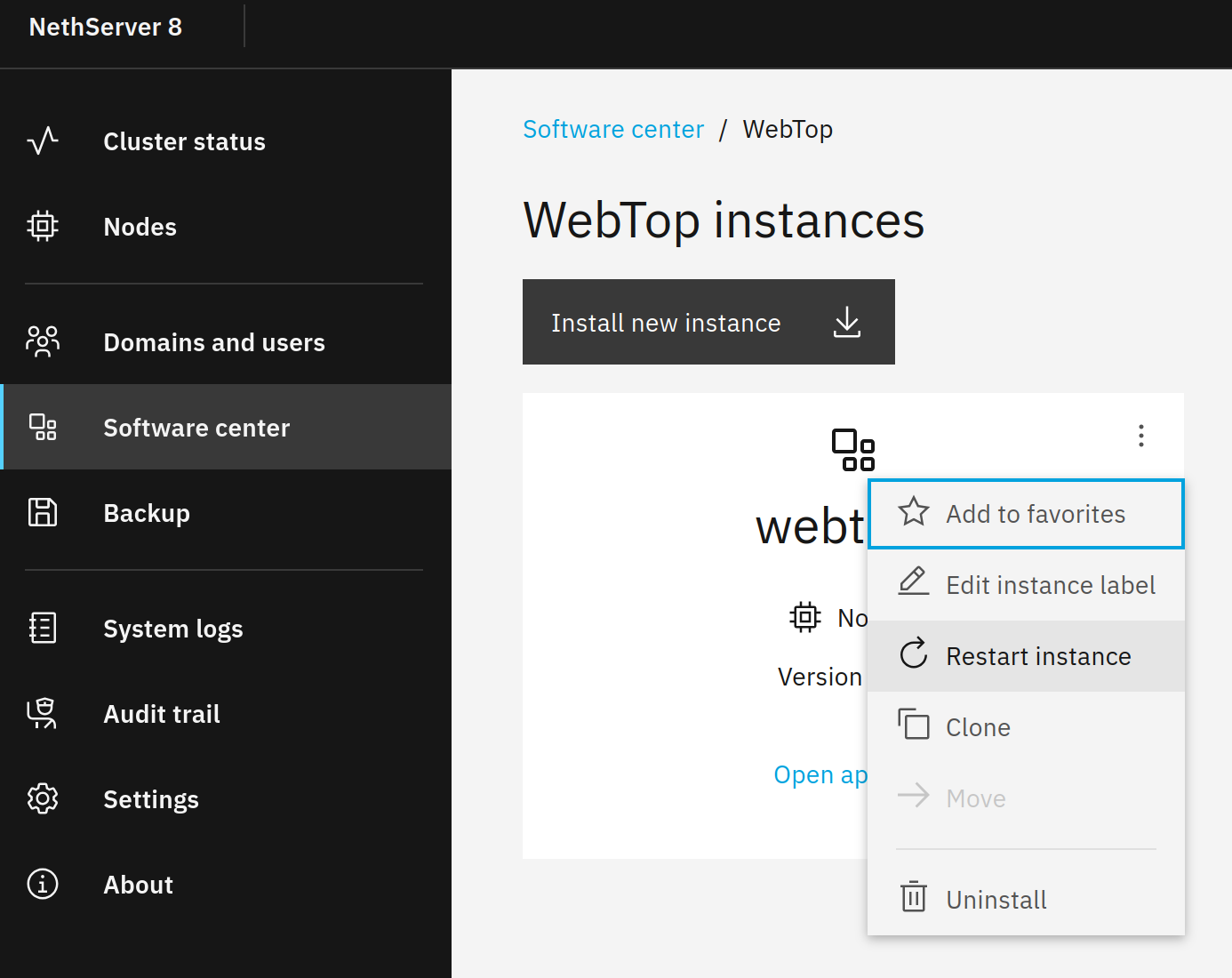

With the newest core it’s possible to restart app instances from Software Center.
On CLI you could try to restart the webtop-apache container:

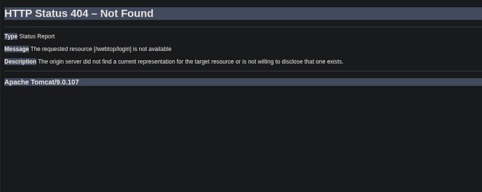

internally I see the following now…
404 page not found
Before I did the updates everything was working ok externally and internally. Is it possible that there may be a problem with Traefik settings now?

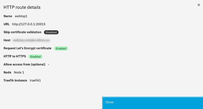

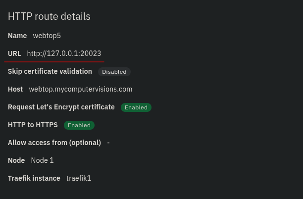

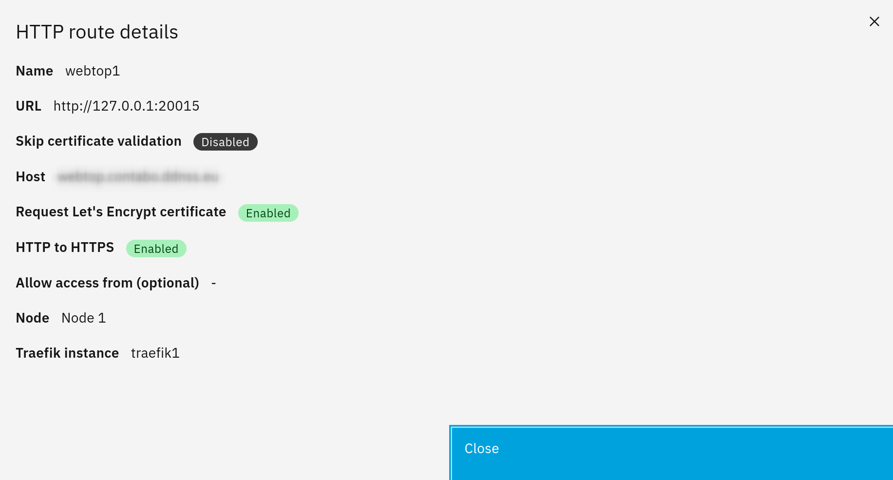

Please check and share the Webtop traefik route:

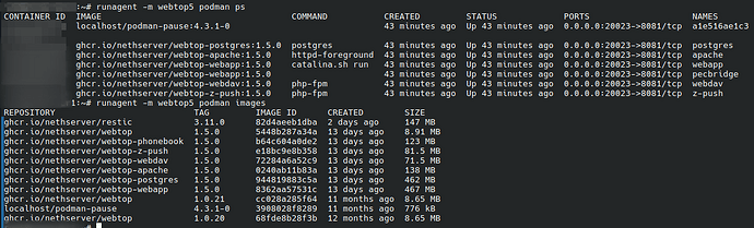

Please also check running containers:
runagent -m webtop1 podman ps
…and images:
runagent -m webtop1 podman images
Okay. I re-saved settings.
Looks like the port is different, but that is the only thing I a can see that is different.
But that would be it. Is that an issue?
No, it looks ok.
Did you maybe customize Webtop as explained here?
So my Webtop is Webtop5
This is what I see …
Are there more Webtop instances running?
Do you use Rocky or Debian?

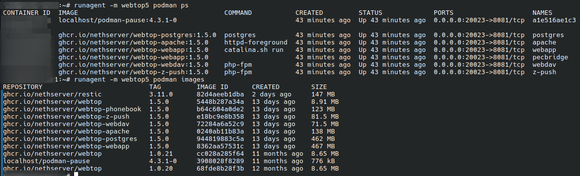

There are more ports listed on my side:
[root@node ~]# runagent -m webtop1 podman ps
CONTAINER ID  IMAGE                                     COMMAND           CREATED            STATUS            PORTS                              NAMES
febe97a266b5  localhost/podman-pause:5.2.2-1746548935                     About an hour ago  Up About an hour  0.0.0.0:20022->8081/tcp            8a7cc3b82f86-infra
72eaf1dd6014  ghcr.io/nethserver/webtop-postgres:1.5.0  postgres          About an hour ago  Up About an hour  0.0.0.0:20022->8081/tcp, 5432/tcp  postgres
0fbb59d72132  ghcr.io/nethserver/webtop-apache:1.5.0    httpd-foreground  About an hour ago  Up About an hour  0.0.0.0:20022->8081/tcp, 80/tcp    apache
3836e5451632  ghcr.io/nethserver/webtop-webapp:1.5.0    catalina.sh run   About an hour ago  Up About an hour  0.0.0.0:20022->8081/tcp, 8080/tcp  webapp
d1ca93ec6e05  ghcr.io/nethserver/webtop-webapp:1.5.0                      About an hour ago  Up About an hour  0.0.0.0:20022->8081/tcp, 8080/tcp  pecbridge
501a9f9ad790  ghcr.io/nethserver/webtop-webdav:1.5.0    php-fpm           About an hour ago  Up About an hour  0.0.0.0:20022->8081/tcp, 9000/tcp  webdav
3e5ed41bc8fa  ghcr.io/nethserver/webtop-z-push:1.5.0    php-fpm           About an hour ago  Up About an hour  0.0.0.0:20022->8081/tcp, 9000/tcp  z-push
[root@node ~]# runagent -m webtop1 podman images
REPOSITORY                           TAG               IMAGE ID      CREATED      SIZE
ghcr.io/nethserver/webtop            1.5.0             5448b287a34a  13 days ago  8.91 MB
ghcr.io/nethserver/webtop-phonebook  1.5.0             b64c604a0de2  13 days ago  123 MB
ghcr.io/nethserver/webtop-z-push     1.5.0             e18bc9e8b358  13 days ago  81.5 MB
ghcr.io/nethserver/webtop-webdav     1.5.0             72284a6a52c9  13 days ago  71.5 MB
ghcr.io/nethserver/webtop-apache     1.5.0             0240ab11b83a  13 days ago  138 MB
ghcr.io/nethserver/webtop-postgres   1.5.0             944819883c5a  13 days ago  462 MB
ghcr.io/nethserver/webtop-webapp     1.5.0             8362aa57531c  13 days ago  467 MB
localhost/podman-pause               5.2.2-1746548935  e3ec47902085  3 weeks ago  813 kB

Can you clarify more ports listed on your side? I am not sure I follow you.
For example the postgres container has ports 0.0.0.0:20022->8081/tcp, 5432/tcp on my side.
In your screenshot the 5432/tcp is missing.

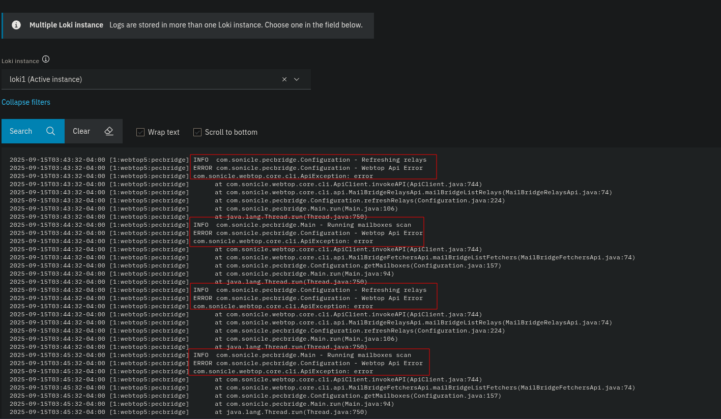

Hmmm so I went under logs and found the following -
Fun…. Thoughts…

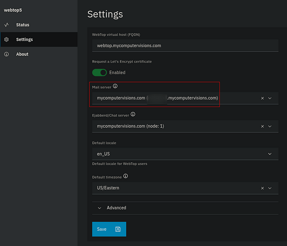

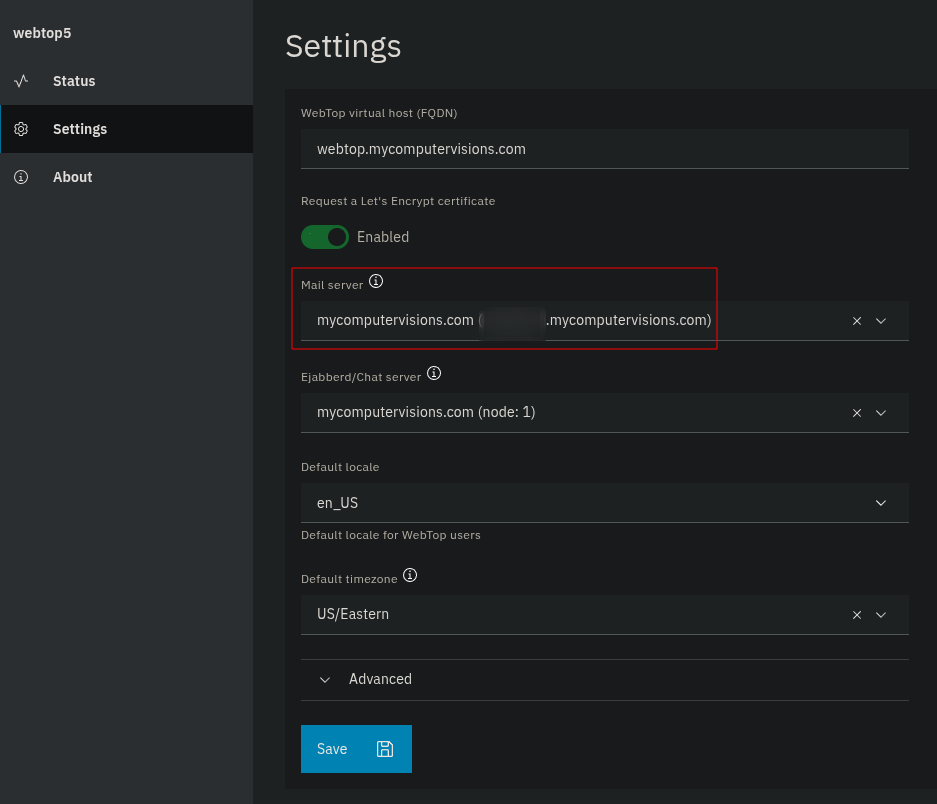

Did you select the right mail server instance in the Webtop settings?

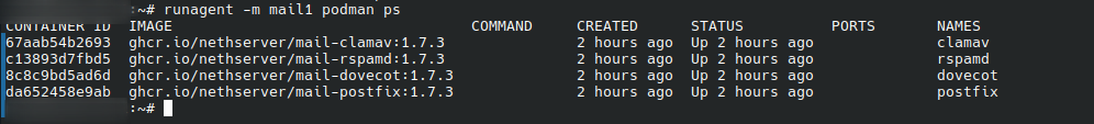

Is the mail server running?
runagent -m mail1 podman ps
I believe it is the correct mail server - (The only selection)
This is what it shows running -

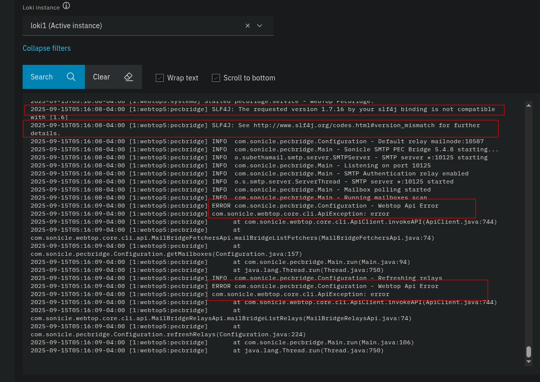

Maybe it helps to restart the pecbridge?
runagent -m webtop5 systemctl --user restart pecbridge
well, it didn’t get the WUI up and running, but I went back in to logs and found the following.
says -
 SLF4J: The requested version 1.7.16 by your slf4j binding is not compatible with [1.6]
2025-09-15T05:16:08-04:00 [1:webtop5:pecbridge] SLF4J: See http://www.slf4j.org/codes.html#version_mismatch for further details.
and
 ERROR com.sonicle.pecbridge.Configuration - Webtop Api Error
2025-09-15T05:16:09-04:00 [1:webtop5:pecbridge] com.sonicle.webtop.core.cli.ApiException: error
@webtop_team
Said to check this out -
Not sure if this is really why I am having my issue, but thought I would at least put up here.

@Shadowfire I found it in the logs that you sent me and I could reproduce.
Sep 15 05:54:07 cvserver1 postgres[27950]: 2025-09-15 09:54:07.170 UTC [34] FATAL: invalid value for parameter "TimeZone": "US/Eastern"
The timezone “US/Eastern” doesn’t work, you could use “America/New_York” instead which works here…
EDIT4:
Bug issue opened.
I did change the timezone to America/New_York. I then looked at the logs. It looks like all the errors are gone now that I can tell.

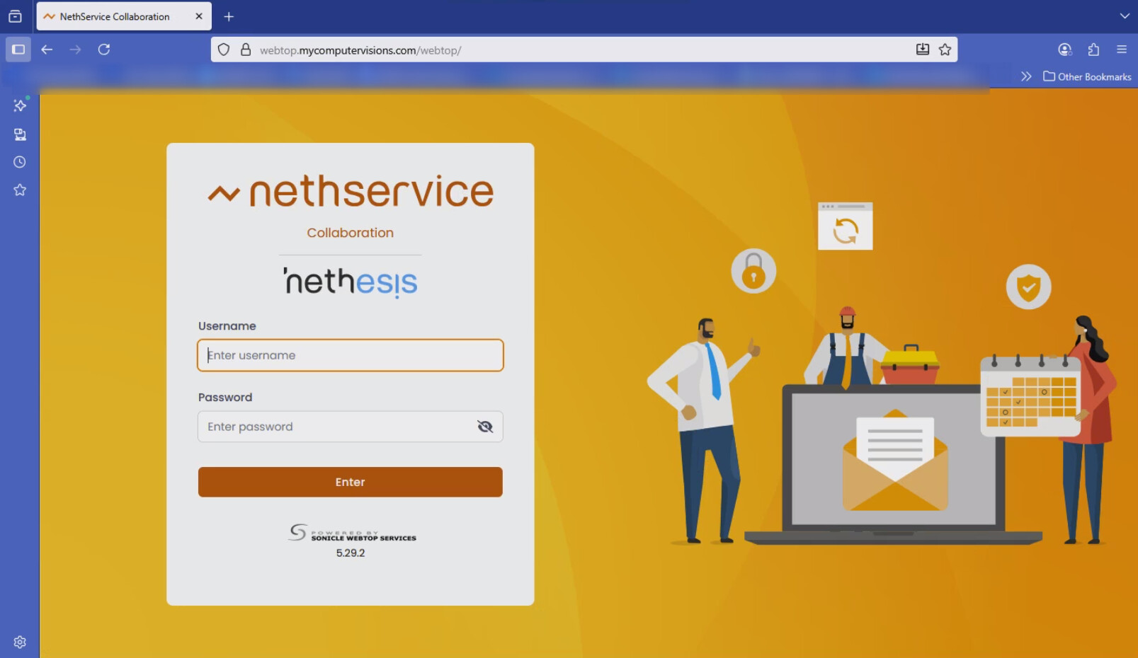

I am testing externally and it looks like it is working externally now. WOOHOO! That was it. wow!
2025-09-15_09-59
2025-09-15_09-591607Ă—930 148 KB
That gets external working properly. Major win! :slight_smile:
