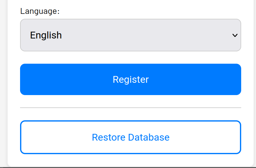

I exported the subscription data from my old Wallos instance as csv and json files. Is there a way to import this data into the new Wallos instance on my NS8, or do I have to recreate each subscription individually?
When you start a new instance, on the bottom of the first registration screen, there’s “Restore database” button, maybe you can import the data that way?
If you already configured Wallos you can revert to a fresh one by removing the volumes… (deletes all Wallos data)

Servus @mrmarkuz
I saw that. But it doesn’t work with .csv or .json files.
