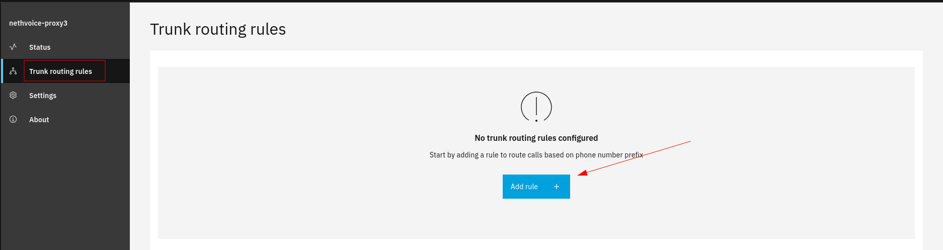

I updated NethVoice Proxy and for some reason I don’t remember Trunk routing rules in NethVoice Proxy. I am guessing it was there in the past, I don’t know how I didn’t notice it, but I am unsure of how to configure it now. So I decided to go read up on it in the docs for NethVoice Proxy link below.
Unfortunately. I don’t see anything in the NethVoice Proxy that talks about the Trunk routing rules and shows examples of setting it up correctly or going over what to do in it.

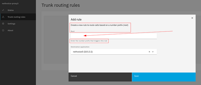

Add rules …

I think with this rules you can set the nethvoice instance to route to by a number prefix but I didn’t test…
When using for example a root number prefix of 123456 to nethvoice5 then people calling 123456200 are routed to extension 200 of instance nethvoice5.
