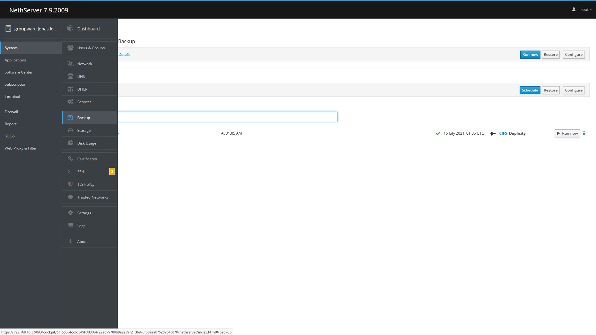

Of course it’s also possible at cockpit.
The configuration backup is pre-configured and saved in
/var/lib/nethserver/backup/
You only have to schedule the data backup.
