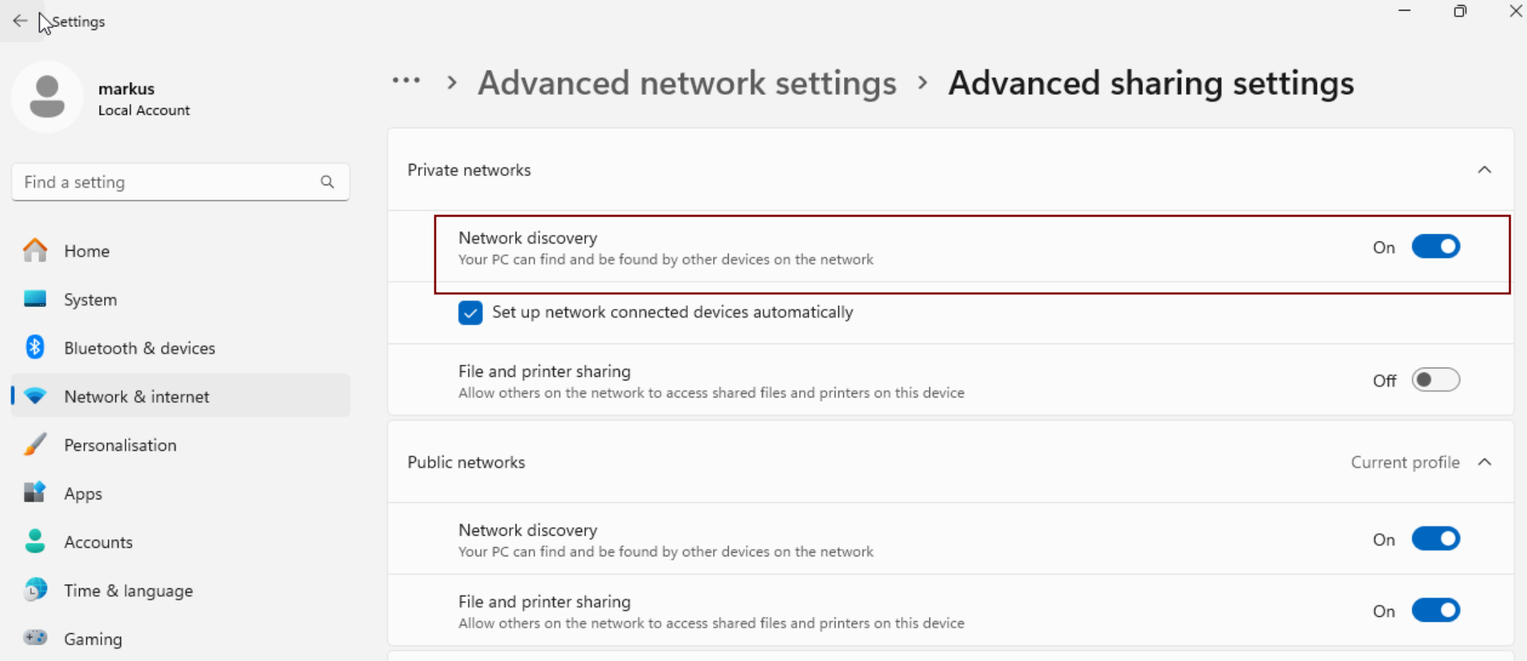

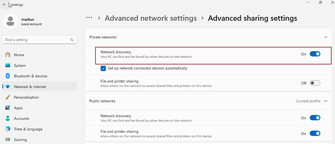

Did you enable Network discovery for the network profile you’re using?
i have a network discovery and this work but per example to reach the firewall by dns, the proxmox server etc. it is not possible by dns just by ip. i did an enry in the forwarding zone of the Samba DNS also but also that doesent work. also the nas everything what is only as DNS on the NS8 is not possible to reach by name just by ip if i switch from the pihole as first dns server, everything works well from the DNS. It seems that also the Samba not accept the entrys what i did in the forwarding zone. nu clue why.
