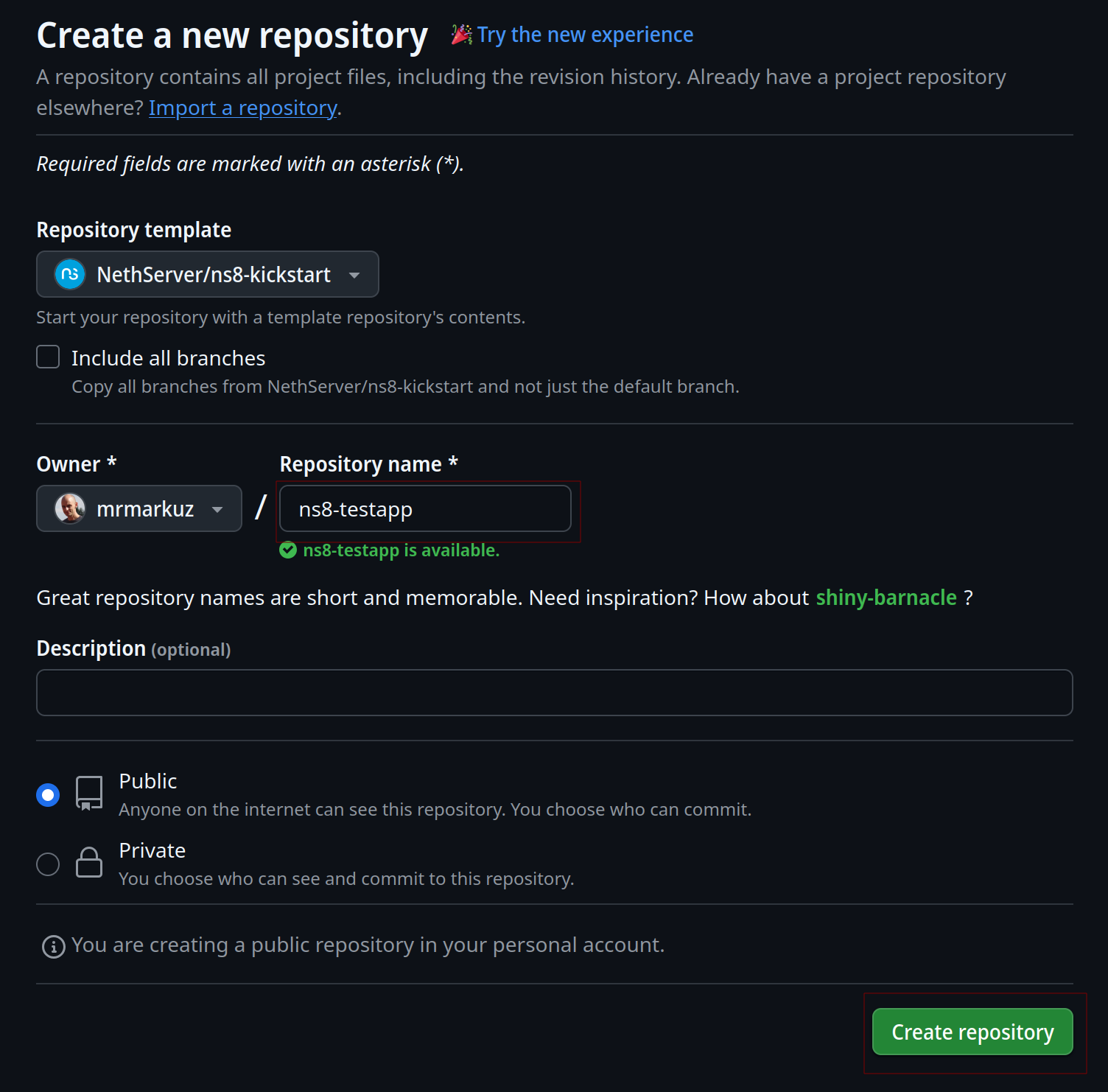

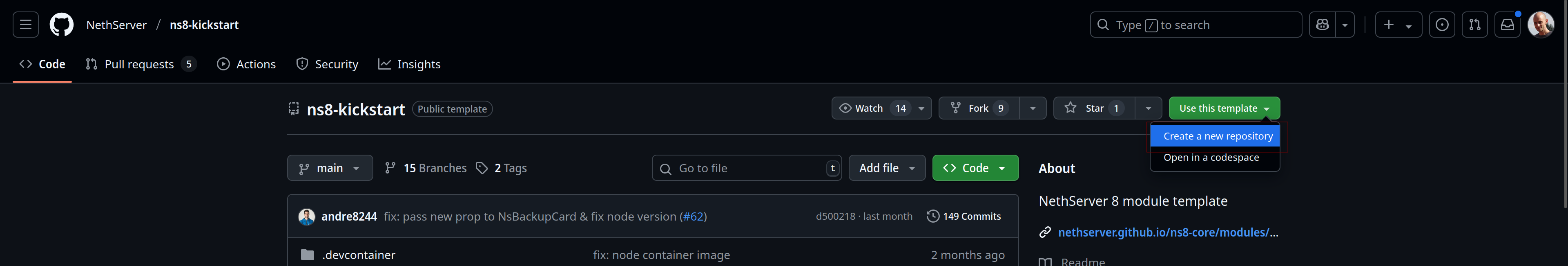

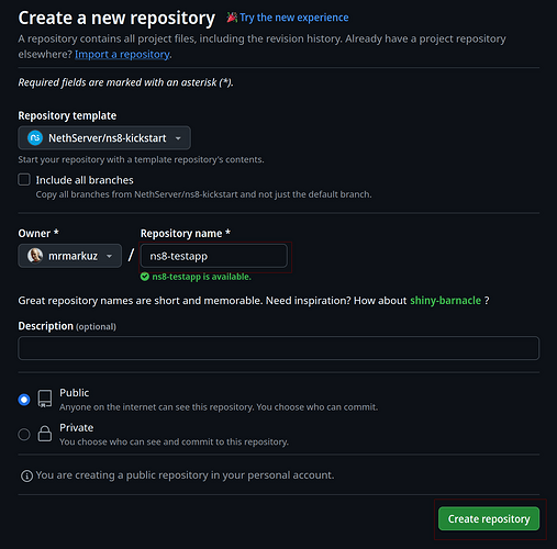

What I did:
Use the kickstart template and create a new repo:
Add a name: (The name should be ns8-testmodule but I used ns8-testapp in the screenshot as ns8-testmodule wasn’t available anymore)
